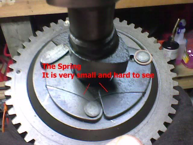

Let me go get a picture of the camshaft with spring and weights so you know what your looking for. BRB
Old 01-14-2011, 09:13 PM
Here are a couple of pictures. If the spring is not attached as it is here you should be able to reach in and slide it over the weight to reattach it. If the ACR tab is broken you will need either a new weight and tab or a good used Cam.

Hey thanks so much for the pictures. That helps a lot. How close to the side of the motor case will the spring/weight side be? Is there room enough to get the spring back on with some needle nose pliers, or replace it if need be without taking the camshaft, etc. out of the block?
The manual says the mechanism is relatively fool proof and the spring is about all that goes wrong with it. I guess we'll see.

I got a visual on it now in my mind how it looks inside the engine. I see the two lifting lobes on the camshaft, so now I know where the weights and springs are relative to the whole part. I'll slip that cover off tomorrow and see what I can see in there. I hope it has just slipped off the weight.

Keeping my fingers crossed for you. I am actually amazed that spring even works, once you see it you will understand.. It is very flimsy. But then again all it has to do is keep the weights pulled in while the motor is starting. Once started, centrifugal force causes the weights to sling out thus lowering the acr tab and not keeping the valve open all the time. Pretty cool design. I am completely replacing my cam. It is good but I want one that is a bit more beefy, if you need a cam let me know.
