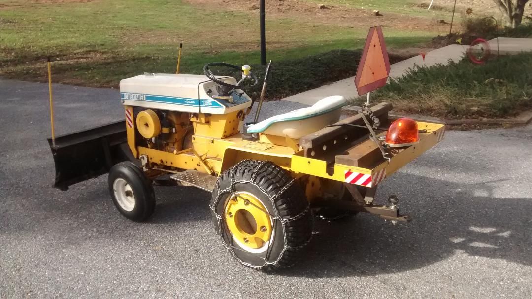

This is a pic of my 125 rear carrier that I made about 15 years ago. It carries a sprayer during the summer and iron weights in the winter for plowing traction weight. It's mounted using the same bolts that hold on the fenders. I was initially doubtful they had enough strength, but in 15 years have had no issues.
I don't think you can do one the same way on later models, but this is what I did. It has wheel weights plus the carrier with about 200 lbs of iron (plus me on the seat) and chains and it will still spin sometimes.
Since this pic was taken, Ag tires were installed on the rear, additional cross chains were added and it now has a cross chain on every other side link. It also has had a hydraulic lift added to replace the strongarm lift.
