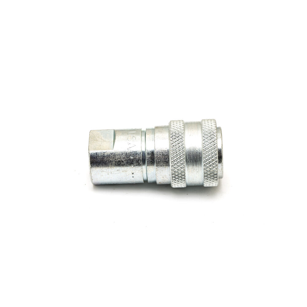

Does anyone know the size of the retaining rings for the frame mounted hydraulic ports? The MTD number is 716-3014. Pictured below is the fitting that the ring attaches to and the rig keeps the fitting snug to the frame.
