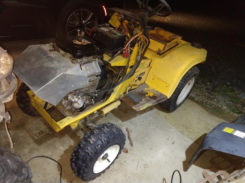

Well the sand hose inside the cabinet had disintegrated and I couldn't find a replacement here. Looks like a wire wheel, rolocs, 1 step, and tubes for these wheels and tires. Ordered the tubes from TSC for $7 a piece. Hopefully ship to store doesn't take too long.

I did end up blasting the inside of the wheels and painted them. Got the tubes today. Driveshaft, fuel tank, and fenders on. A few more wires and it should move on it's own.

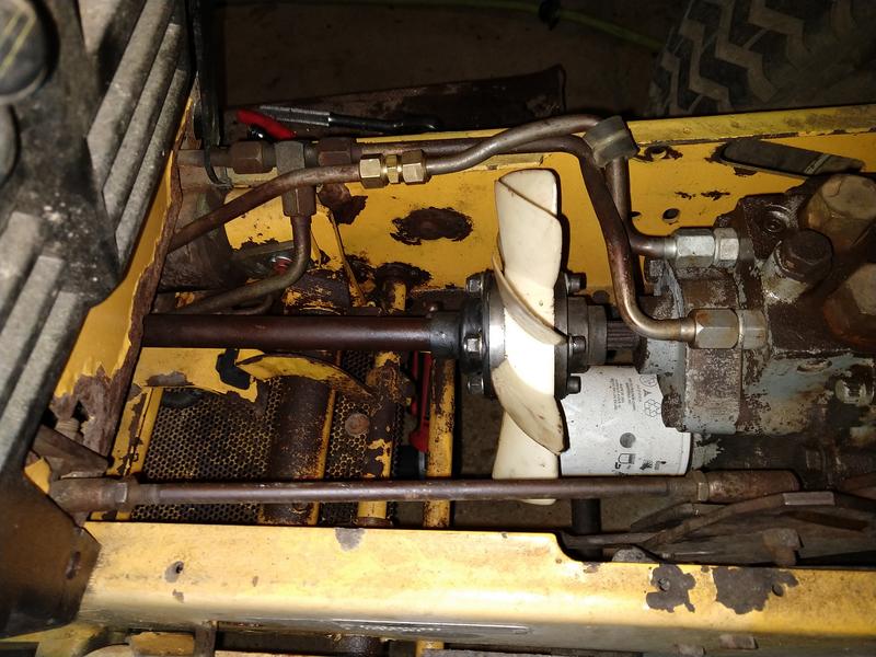

Does that fan clear the filter?
Fan should be mounted to the front of the CV joint.
I knew you would catch that. It did clear because of the shorter filter. I ended up moving it to the front, like it's supposed to be. I didn't like the idea of the plastic between the CV and adapter. I had to trim a little from the fins to clear my compression fitting in the line.

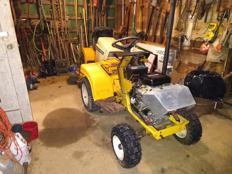

Got motivated enough tonight to get it running and drove it into the shed with it's younger brother, the 1864.

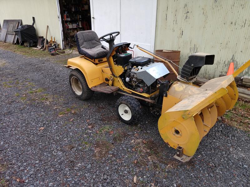

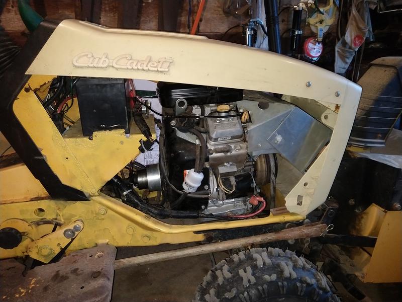

Put the seat on. Installed the PTO and got the blower hooked up today. I put the 1864 out back so I can have some room to work inside and out of the wind tomorrow. Getting the plastic on the front may take a little bit of rigging and a lot of shims. It's definitely seen better days.
I did have an issue with the exhaust pipe hitting the heat shield on the blower. For now I bent the shield, but need to bend the pipe as well.
