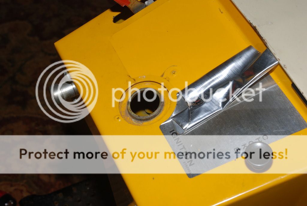

Mystery solved. Has 2 rivets. I hope that's all that's holding it. Good thing I didn't give that dash decal away.
Old 10-21-2016, 10:43 AM
Posts: 6,907
Drill them out and install the correct rubber grommet Ronnie, and replace that dash decal

Looks like to me, the grommet will cover the lower one and a new decal will hide the other one.
Randy
Yes, and I have all the dash grommets and the decal. I just hope who ever made this mess didn't weld it also. I don't have a torch, and don't know what to do if it is?

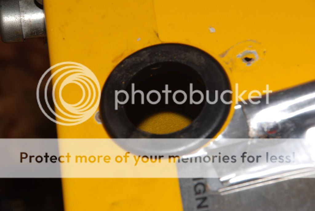

Got it out. Drilled the 2 rivets and it fell out. Installed a new grommet in the dash, and now just have to put the steering column back in.

Drilled out the 2 rivets and that piece just fell off. Installed a new grommet in the dash, now just have to put the new steering column in.
Old 10-21-2016, 06:06 PM
Posts: 6,907
Looking good Ronnie!

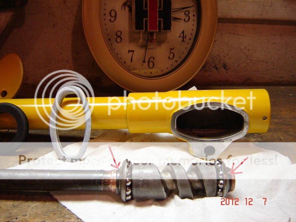

Now I need a clip. I have it marked in red. Where can I get some?
OK, No answers? I got 2 of the retainer rings on the way from CCS, and a new thrust washer and washers. We will see if that makes this old girl seem like it has power steering. I just don't believe it? AND, Thanks to Todd for the picture. I have looked at them many times messing with this steering column mess.

Do you have the plastic ball bearing holders or are the bearing cups just stuffed full of ball bearings?

What's wrong with your snap rings Ronnie?
Why don't you post pics of your parts instead of using Todd's pics?
Bill
[QUOTE=J-Mech;397107]What's wrong with your snap rings Ronnie?
1.There were two of those plastic holders there. Can't I remove them, and just use the bearing cups? The plastic is old and worn.
2.I only have one, and need two.
3.Todd's picture is much better than any I have. And I did give Todd credit for his wonderful clear picture Johnathon.
