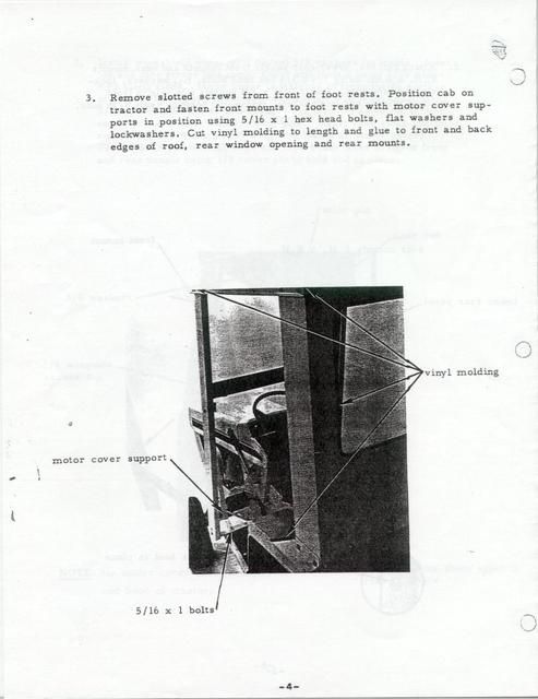

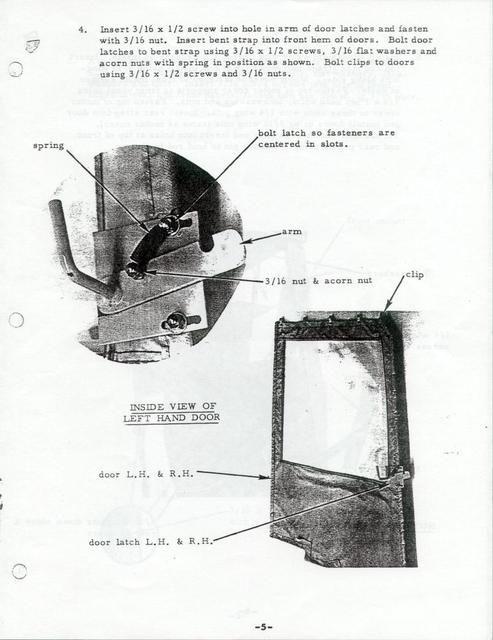

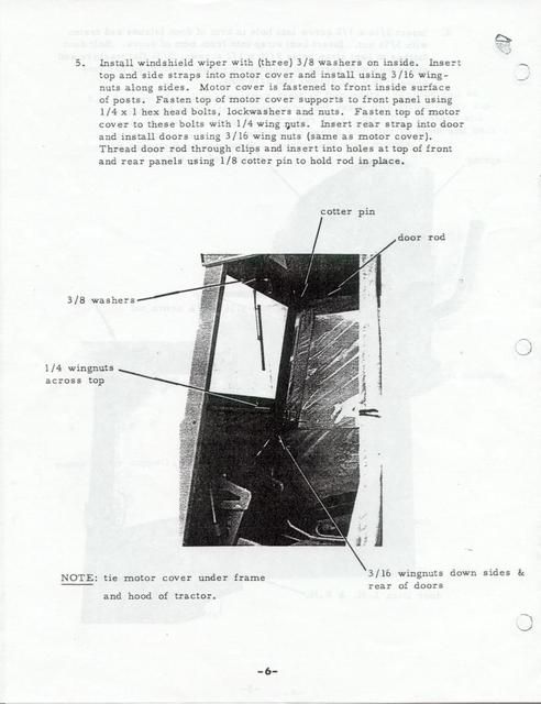

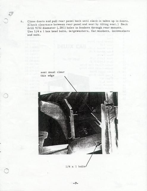

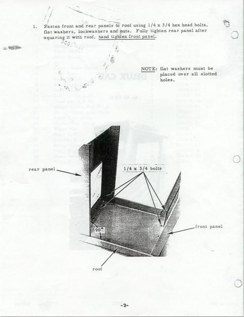

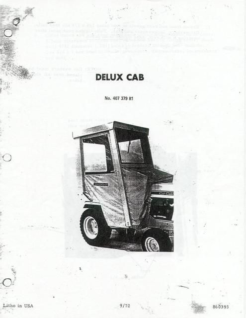

Originally Posted by jheath View Post
That's awesome if you have the manual. I will post pics when I get home from work.
Maybe Roland got a better copy (PDF) but I give you what I found:
