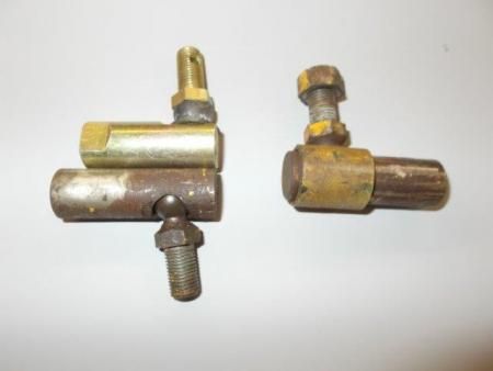

Here's what the rod ends look like.
The thread is 3/8-24 NF ( 3/8 fine thread ) and you will use a 9/16" wrench to tighten the nut. One wrench on the threaded portion and the other wrench to tighten the nut.
Jeff

And if you can't find the tie rod end that fell off or it's damaged or just need replacements;
http://www.onlycubcadets.net/forum/s...6&postcount=35

With a bit of luck, it is merely missing the nut. Good luck!

Yep, I got the nut back on it after the good photo with the arrow on it.
Steers well now, ha ha.
