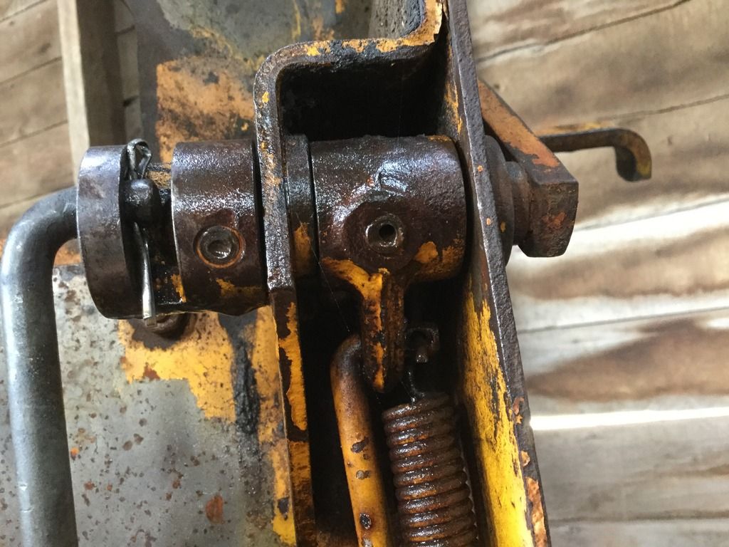

Is these little guys supposed to come loose? This is what i was referring to.
Sorry if i was not clear.
Those roll pins?

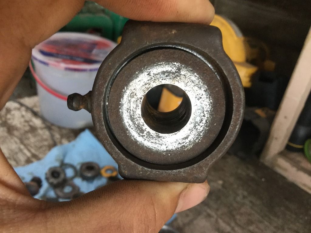

Bushing supposed to have this much play in the collar?

Yeah, the roll pin in the first picture can/will come out.
Sure, the spiral pins will/can come out in the second picture, but why would you want them out?
No, there should not be that much play in the collar and bushing, looks to have been wearing on the collar... Looks rather dry also. Did this clutch work when you got the tractor, or haven't you tried it?
There are some parts of the assembly that are no longer available, and you would have to have them built. Jeff in pa builds parts for these tractors.

I sourced the Timkin bearing and thrust washers plus the bushing from my local bearing supplier. The hole for the brake rod in the second pic tends to get wallered out. I took mine out but remembered the order. As Todd said though it's not necessary unless the pedal is sticking and not moving freely.

The clutch worked before. One day my father was driving it. Funny, because he thought it was a piece of junk. Next day, Got on it, started it [ He forgot to put it in neutral when he shut it off] Cranked the engine and BOOM it took off. would not stop. Hit my brothers JD 110 grille and put a dent in it. Cub was not hurt though. got it in neutral and tried backing the thing but the clutch plates were stuck. Got them unstuck and backed out of my shop. And it would not stop.
Figured by then it was time to take her apart and make it nice again. Watched a couple videos and took the clutch apart and cleaned all the parts and let them dry. Thats why the look dry, Todd. So i may need a new collar and bushing?
Do springs usually need replacing on these clutches? Mine looks fine.
