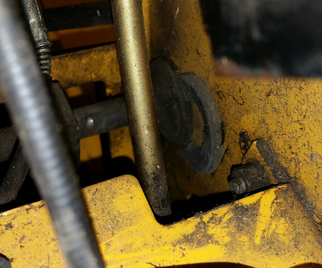

Found the problem with my forward/reverse lever jumping. I hate working on things idiots have screwed with, check out his friction washer replacement job:
Saw another post where a guy says he took out the battery tray and was able to gain enough room to replace it without taking the entire dash apart. Anyone else ever try it? He said he had to pry the dash out a bit to get enough room.

I replaced the friction washer a few years ago. I removed the plastic side panels for some access and used an open end wrench on the nut. As I recall, I did not disassemble any part of the plastic dash. It was a snug fit for the nut/wrench and I may have flexed the black plastic slightly. Sorry, no pictures.

That is what I'm going to try, the other post I read said the guy took the battery tray out also. Thanks.

Got a little more done to the 1864 over the weekend. Friction washer is a PITA, lol. I could do it much quicker if I ever need to do it again though. If anyone is interested I pulled the battery tray to get more access and just zip tied it to the top of the dash to keep it out of the way. If I were to do it again I would seriously think about pulling the deck, it was a pain leaning over it and every time I dropped something I had to look all over the deck for it.
The only hard part is getting the shaft that the friction washer goes on out of the dash tower. It sticks out of both sides and has a flange on each side inside the dash tower prohibiting it from sliding out either side. What I ended up doing was using a pry bar that was bigger than a large screwdriver and had the bent end on it like a crowbar. I put a small block of wood on the dash tower then pried off of the flange on the shaft and popped it out. Tried it originally with a screwdriver but between the flex and not having the angled end it wouldn't work.
