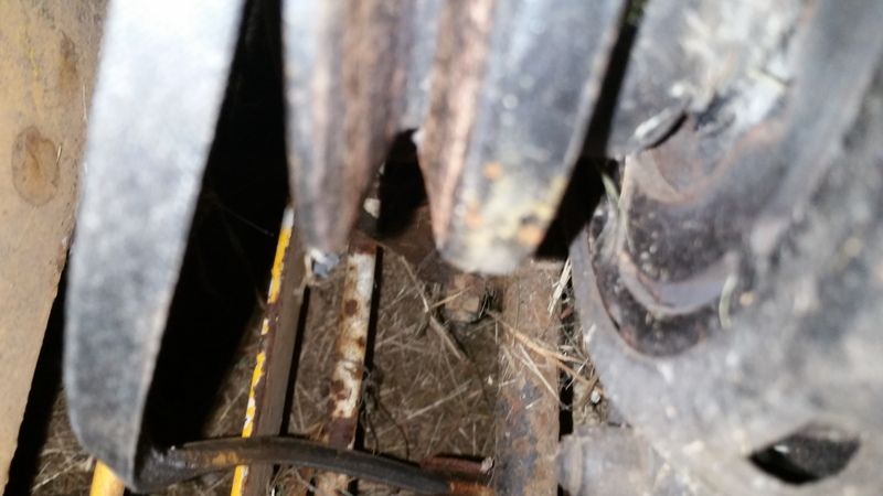

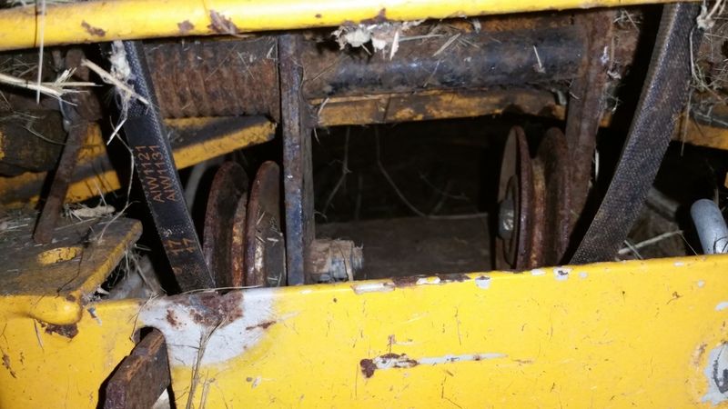

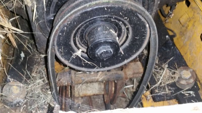

here are pics of the mule drive etc...
idle pulley bearings on the mule feel great but they are a bit rusted, the pto doesnt feel bad.

Is that the right size belt? Looks too wide. Should be 3/8 in. IIRC.
no it was a shorter belt I was trying after I smoked the correct one.
