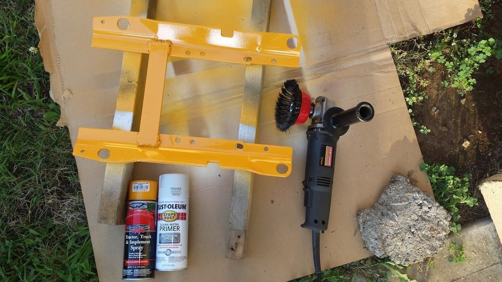

Well I got the flux core welder from HF. It did the job although it was pretty ugly, I should have practiced more but it worked. I had the rails mounted with my new solid mounts from Jeff in PA and also bolted in the oil pan so I had a nice sure fit when I welded it.
I also decided to make this my first painting project too since the cradle is easy to strip. 9 bucks for the paint and primer.
I read a few places that 'school bus yellow' from tractor supply is a good color for cubs and I think I agree. here is a pic after primer and 2 coats from the rattle can. Very basic but I'll take it.
- Tim
Old 07-24-2015, 08:51 PM
Welds need more heat but the paint looks good
Before you know it you'll be a master welder. No worries, I have similar welds on my aerator hitch and it holds 250 pounds just fine

Looks like you're getting right into it!, Good job. I agree, school bus yellow works good for me, plus it matches the color on my loader, dozer and pipe staging, one can does it all. I get mine at the local Ace hardware. How pretty the weld is really about the flux core wire, my experience is that it is almost impossible to get anything to look nice with that stuff. Weld may be plenty strong, just kind of ugly (sounds like me). Get a tank of gas and I'm sure you'll be laying down some beautiful beads. Keep up the good work.
