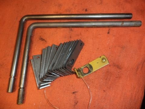

I talked with Jeff during his engineering stage. We noticed that the NF and WF handles have a 10 degree rotational difference in the hole locations. You might probably have to bend the handle a little to make it work properly.
It seems that it would probably work with the tall tunnel NF models.

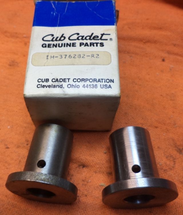

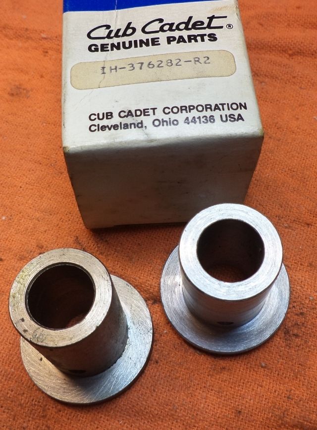

Ready to start on the Original clutch bushing tomorrow.
Which one? I just rebuilt 2 original clutches but sourced one of the bushings locally. Is one of them NLA?
Old 03-30-2015, 12:09 AM
Posts: 11,266
That would be this one,which one did you find alvy?

I didn't find that one although I found and replaced the brass bushing that goes inside of it and the timken bearing and timken flat washers for it as well locally. I can see the need for it as the timken bearing area gets a big groove in it and that thrust area gets thin. Good job to all involved here.

Jeff does a super job! He sent me the prototype handle. Haven't installed it yet been too busy swapping engines around but looks great!

I just made the first one ( right side )
