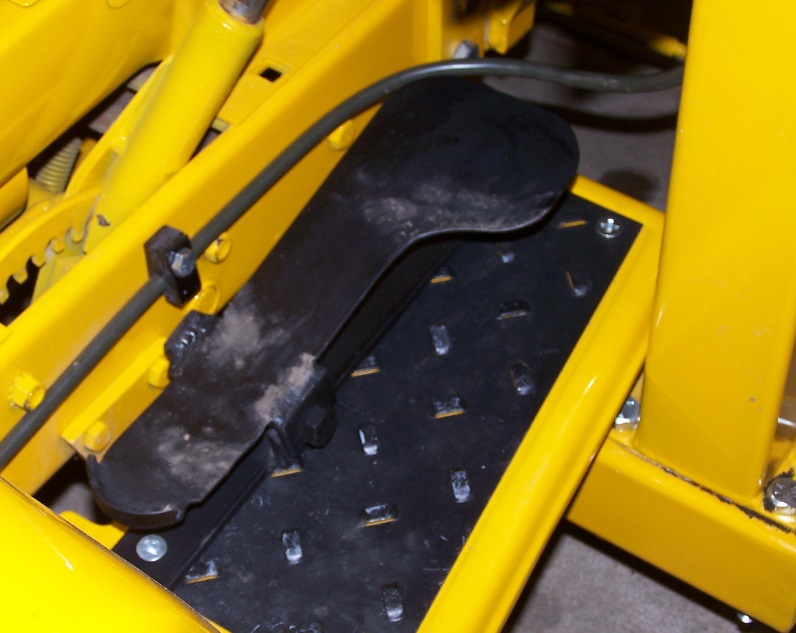

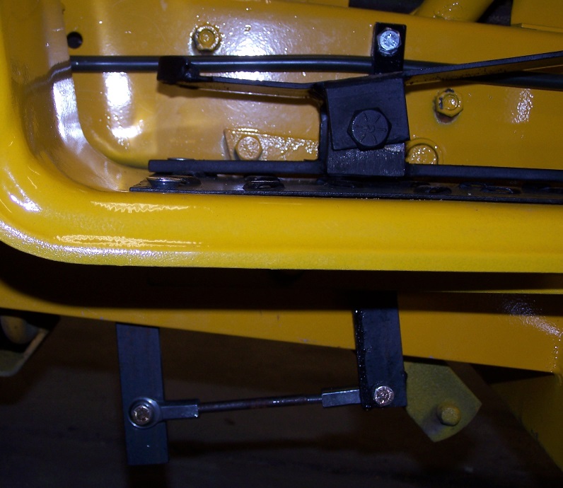

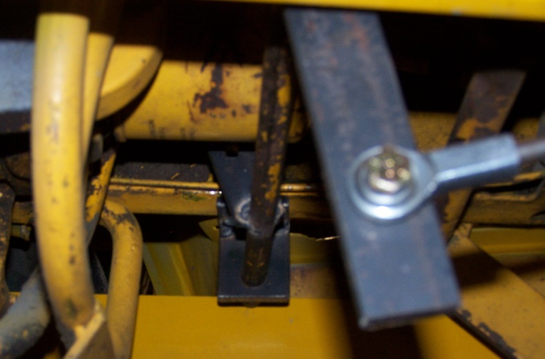

Over the weekend I was able to get the foot control made up. It is linked to the bottom of the hand control with a cross shaft running just below the filter.

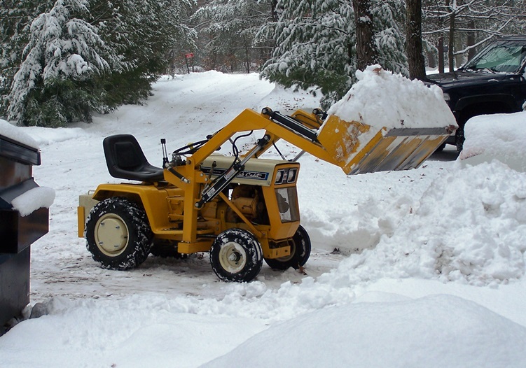

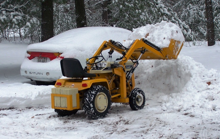

Got a little seat time in the snow today.
Old 12-08-2014, 01:23 PM
Posts: 18,911
Well that sure beats a shovel! Sweet looking tractor. POTW material.
