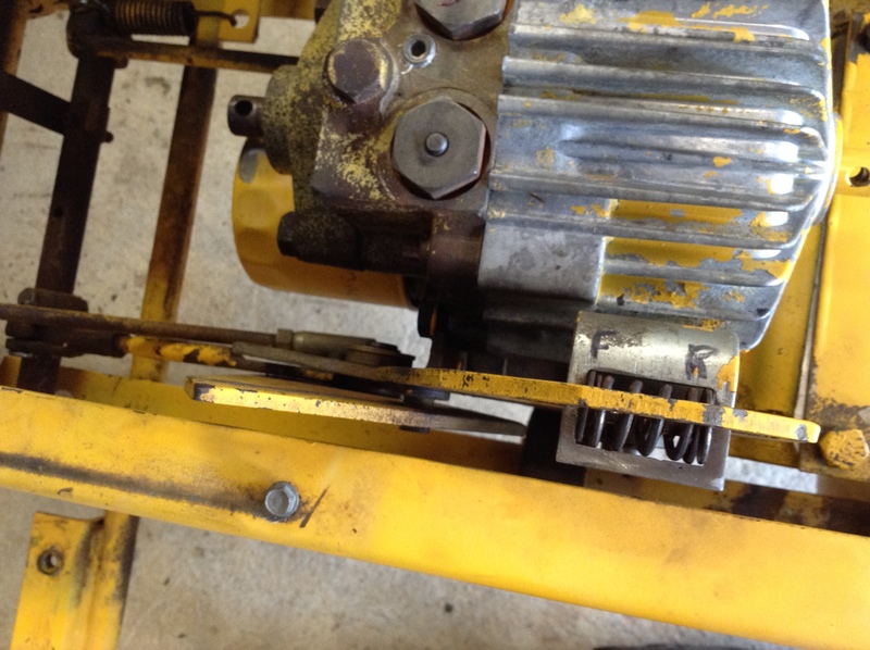

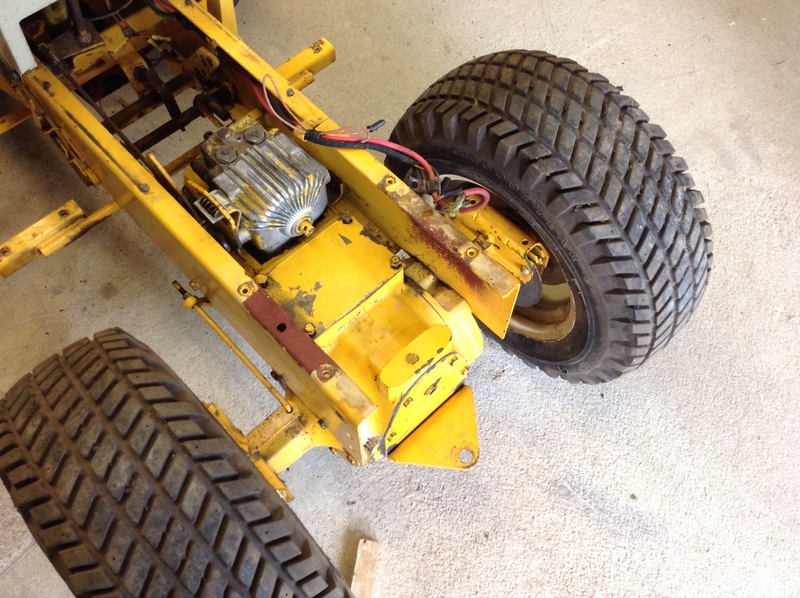

A little more progress.
Rear end is bolted back in and the hydro linkage is all hooked up:
I was able to add a washer to the pivot points to tighten things back up a bit:
I need a new filter and some Hy-Tran before the fenders go back on. I also put new tie rod ends on and greased everything up. The chassis is more or less done baring some unseen disaster.
Just waiting on the machine shop now...

Question for ya. The link that goes from the hydro to the brake mech, how is that attached? Did you use a bolt or something? When I bought my 127 this link was not attached back to the hydro and all I have is the yoke on the end of the link and no pin or bolt. Just trying hard to find out what that part is.
Which end?
On the brake side it's a yoke with a pin that goes on a brake on the brake shaft. On the other side it's hole that slides over a stud on the speed control plate.
Unless something major is missing it should be fairly obvious.
K

Originally Posted by kopeck View Post
Which end?
K
Ah thats what I needed to know. Im working on a NF tractor and it's kind of hard to see that. Thought I needed a pin or something. Thx

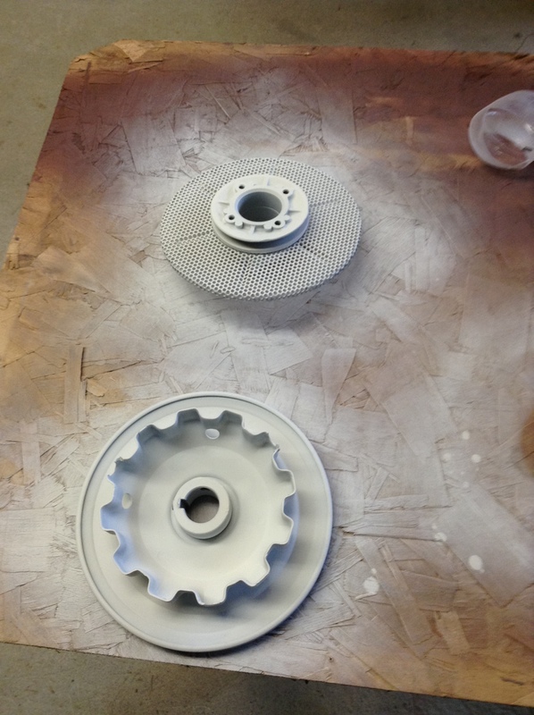

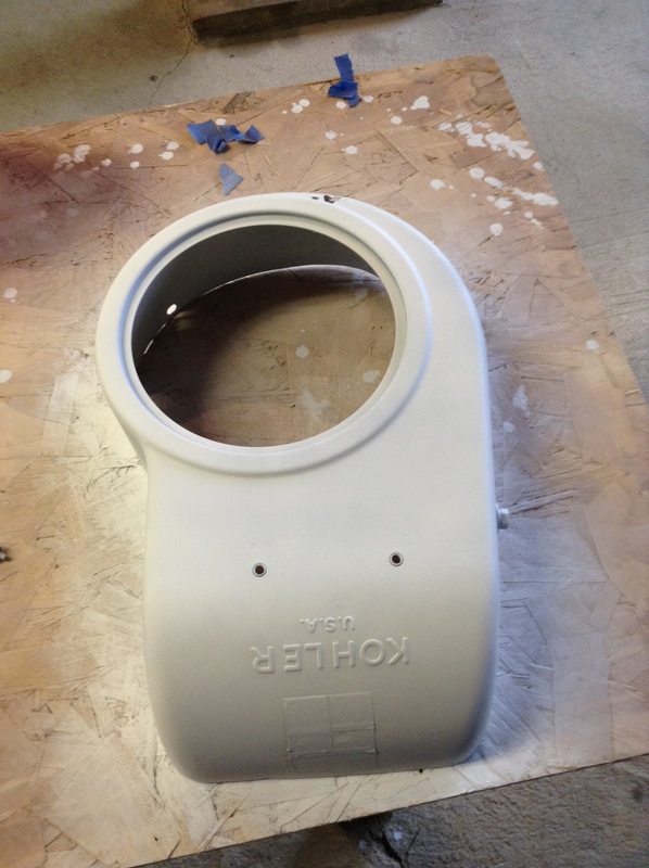

The machine shop has completely derailed this project. They have had the 321 for 8+ weeks for just a .010 overbore and turning the crank .010. Just just got word that it was done, now I need to find the time to go it it.
In the mean time I cleaned and primed some parts:
