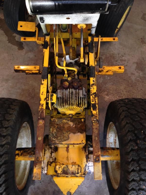

Looks like you could also use a new hydro fan.

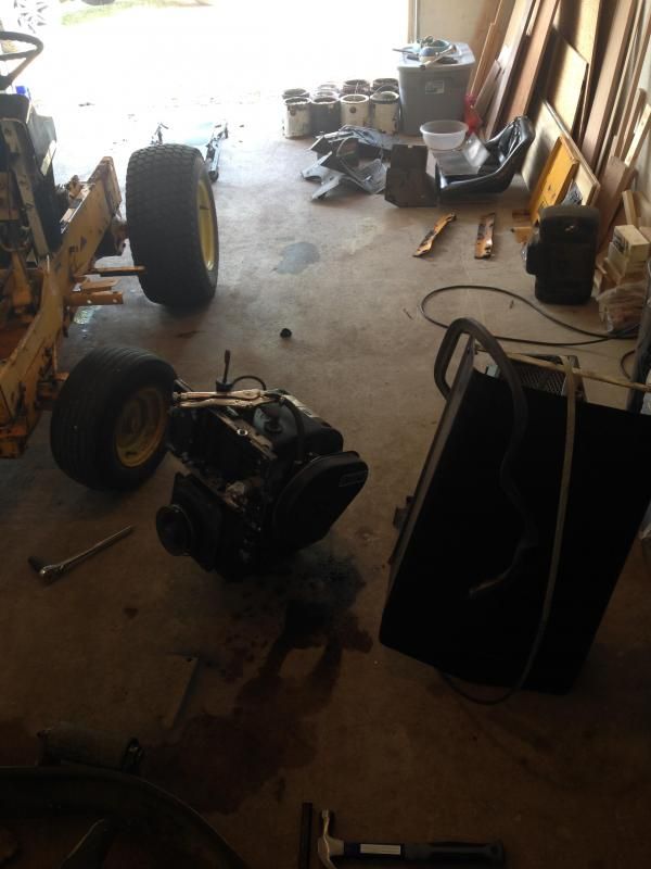

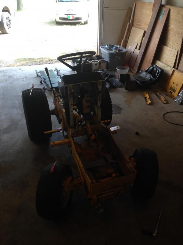

Well, got a little more work done today.
Cleaned it up a little to see what what i was working with and pulled the Engine.
The parts are piling up
And now the wait for the PB blaster to release my steering wheel
Old 06-22-2014, 11:26 PM
Great job on the tear down. You'll find many ways to get the wheel off but I like the airhammer method the best and put a 5/16 bolt inside the tube to hit on. Some up pressure and it pops right off.
It cleaned up well, I will be watching your thread, looks good
