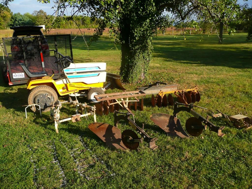

I have some attachments I need to give a try someday. These was with one Cub I got.
