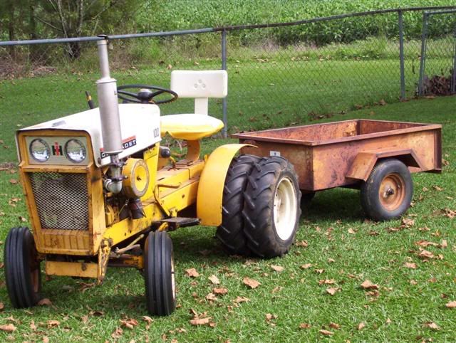

Jeff,
The tire size is 4.00-8. You'll need different rims. Here's what the narrow tri ribs look like. Hope this helps.

They look great. Any particular reason why you went for the narrow ones? I notice only two dimensions for the tires. Also, that's exactly what I want to do with my exaust.
Old 01-20-2010, 03:50 PM
Jeff,
Thanks! The tires were already on the tractor, before I got it. They steer great. The stack was already on the tractor, as well.
