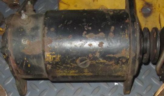

Find someone with a junk S/G and see if you can just purchase that part off of them......there's got to be one out there somewhere.
Old 12-08-2012, 11:46 PM
ihcc104's Avatar
ihcc104 ihcc104 is offline
Location: East Haddam, CT
Posts: 621
I have one that smokes like no tomorrow when it is used and is for parts... What part do you need off of it? What's the shaft nut?
http://www.cubcadet.com/webapp/wcs/s...A/040011200004
What parts do you need, Parts 44,25 and 26?
- Cory Sanderson

As promised:
The shaft is about .660 Dia. and 20 threads per inch.
Nuts from any Delco Generator (GM) and later Alternators fit.
Yea the pulleys swap too, for some special modification a fellow might want to do
(Like 2 or 3 grooves)
Did I mention,
Ford Alternators use same nut also?
I don't think it would be hard to find one anywhere,
just use your imagination.

[QUOTE=ihcc104;163663]I have one that smokes like no tomorrow when it is used and is for parts... What part do you need off of it? What's the shaft nut?
How about a 22,44,25,26? (22 is the small spacer behind the pulley).
PM me with cost, etc.
Thanks!
John

As promised:
Did I mention,
With this many nuts, you'd think it easy to find one! I'll see if I can find an old alternator around here!
Thanks for the info!!!
John

Found a nut on an old alternator I had rat-holed 40 years ago. Fits perfectly. Thanks for the info!!!
The 100 now has a new S/G and a new regulator. Charges on startup at about 13 volts. I am happy!
First time this tractor has charged correctly in years! Seems to run better and have more power, too!
Thanks to all!!
