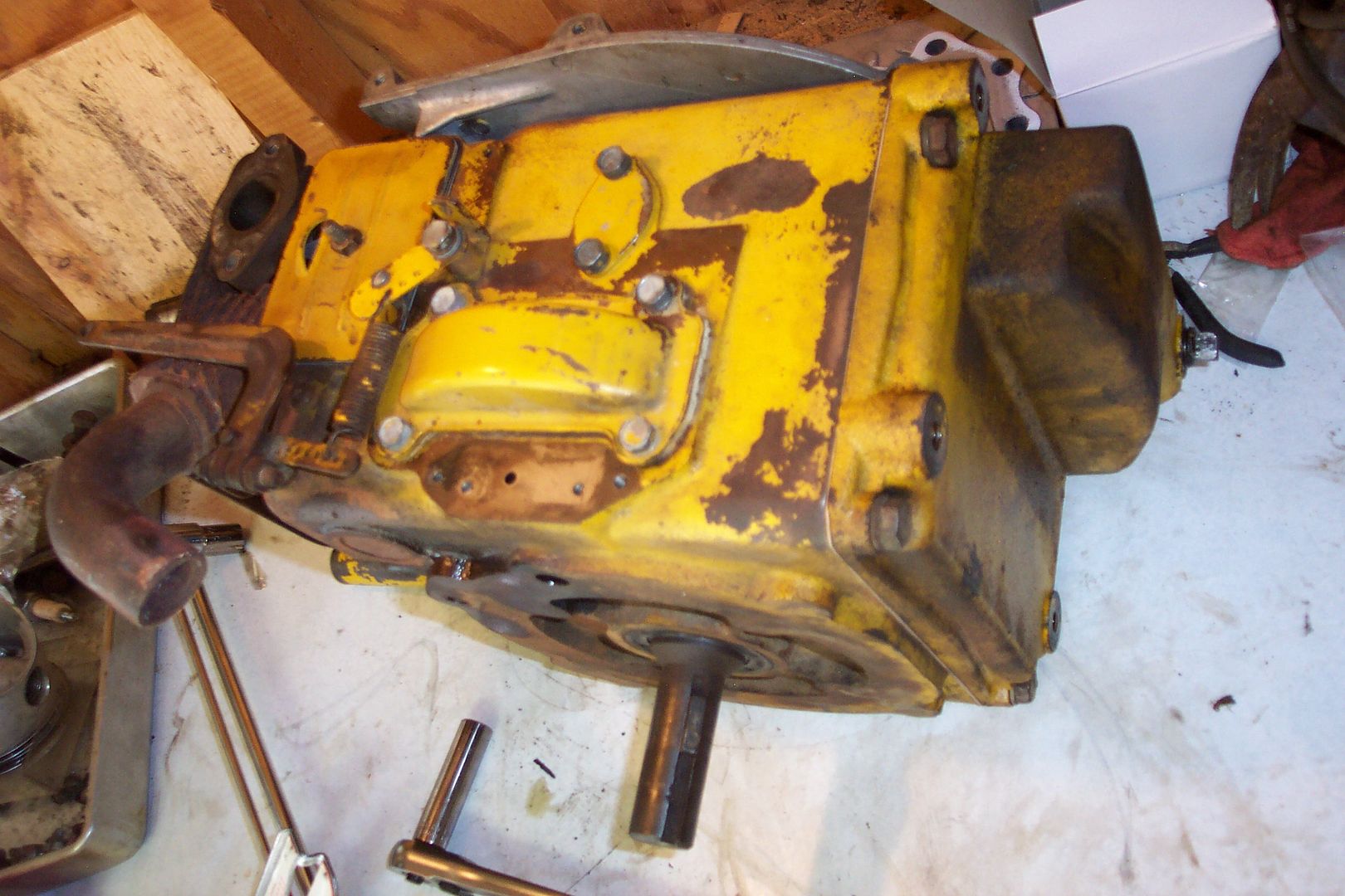

click for bigger picture
That's a picture of a K301 Kohler laying on it's side. See the "lump" on the bottom of the oil pan? That is one way to identify a 12 hp from a 10 hp Kohler ( 10 hp is flat )
