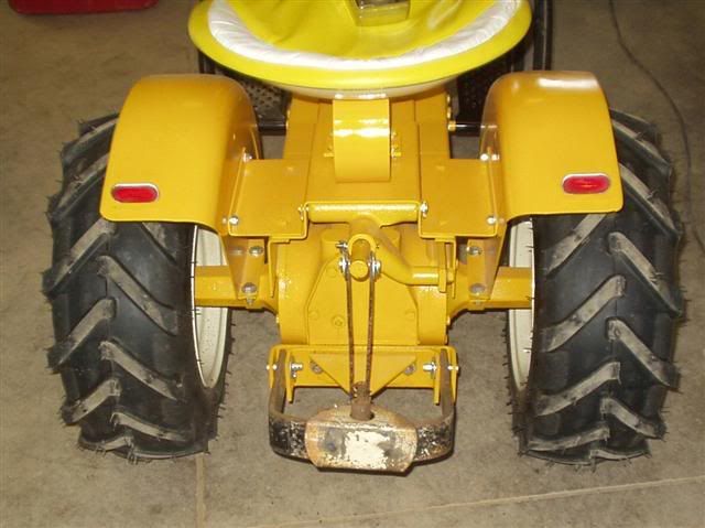

Been working on the sleeve hitch for the 169 this week.
Got it finished and installed.
Now they both have them

Diz Jr.,
Well that baby won't twist! Great looking Cubs ya got there.

Your sleeve hitch looks great, Diz! You did an awesome job! Thanks for the pics.

Twisting isn't the problems I see on the sleeve hitch adapter. The lack of support on the outside can and will cause the holes to elongate some. The only way I found to cure the problem is to go to support on both sides of your sleeve hitch adapter.
International Harvester design and build a tiller, box blade and a rear blade/rake. All 3 attachments have support on both sides.
Some use a rod that goes between both arms of their sleeve hitch adapter. That helps....rod could bend.
