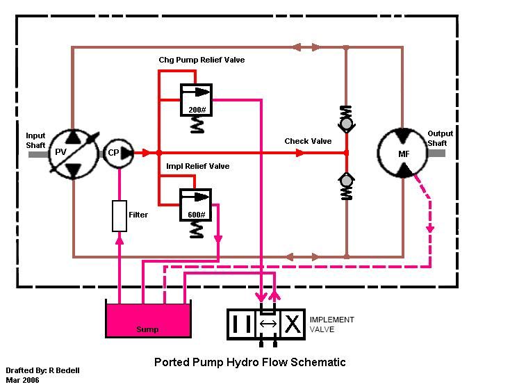

OK. Does this sound correct? The charge pressure is higher than the lift pressure. On a ported pump w/ports capped the relief valve on top acts as the charge pump relief. when you add an implement lift you change the location of the charge pump valve to the side. ANYONE?

I found the flow circuit in the pump. Thanks R Bedell!

thats just confusing. whats MF CP and PV? i hate hydros so far. lol
Old 11-22-2011, 06:41 AM
CP = charge pump
PV = input valve block assembly
MF = output valve block assembly

Well that flow chart answers my question on looping the ports...BUT!!!!
Sorry this hydro stuff is foreign to me, I need to study!!
Thanks
Clay
I have been staring at that flow chart.
Is that a typo of the implement and charge relief valves labels being swapped?? Maybe I have been staring too long.
Also, the implement relief can not be higher pressure than the charge, can it?
All the oil would go to the lowest relief valve in a parallel circuit!!??
Maybe when there is no implement circuit, the charge can be 200psi, when the implement circuit is added the pressures for both have to be increased.
I do not know for sure, but, I would think you can not get 600psi out of a 200psi circuit.
Kind of like wishing you could get 600psi at the garden hose of your house to wash your Cub Cadet when the rest of the house is 50psi.
I'm lost, I think is will go wash my Cub Cadet!!

I'm with CADplans
I didn't think the pressure could be like in the chart
That's why you need to swap out the valve springs when adding an implement lift, Right?

You know what? Im just as confused. How can it loop around like that in the relief valves? I see a lot that dont make sense but maybe im missing something. Im having issues with the colors too, Im partially colorblind and I can see a difference sometimes but staring at it just starts to blend in and my eyes hurt, lol.
Also page 9 of the 169 hydraulics add on setup pdf http://ccmanuals.info/pdf/169%20Hydr...On%20Setup.pdf the charge pump is on the side and implement is on the top. My ported 129 that came with manual lift (so the ports are blocked off) has the spring and cone in the relief labeled implement and nothing at all in the relief labeled charge? So I dont why the implement would have the spring and cone if there was never an implement beign used. I guess less time in front of the computer searching and more time out tearing it apart would probably help all this, lol.
