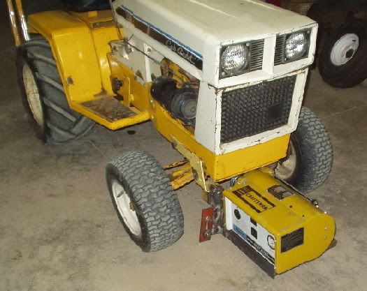

Picture No. 1 - 149 from front
Picture No. 2 - looking at tractor from front left wheel- square level approx. 1.25" difference between top and bottom
Picture No. 3 - looking at tractor from front right wheel- square level approx. 1" difference between top and bottom

You have positive camber, which is correct, set the tow in 1/8" and it possibly
will be the same camber on both sides.

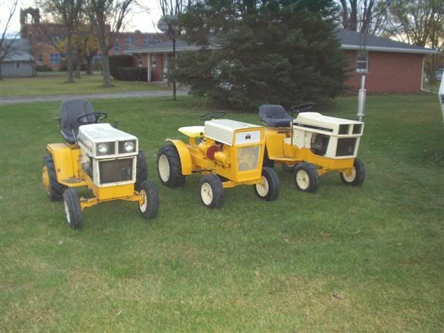

Here is a picture of my 149 (one on the left):
My front wheels have the same positive camber your Cub has.

Another view on my 149's front wheel:
