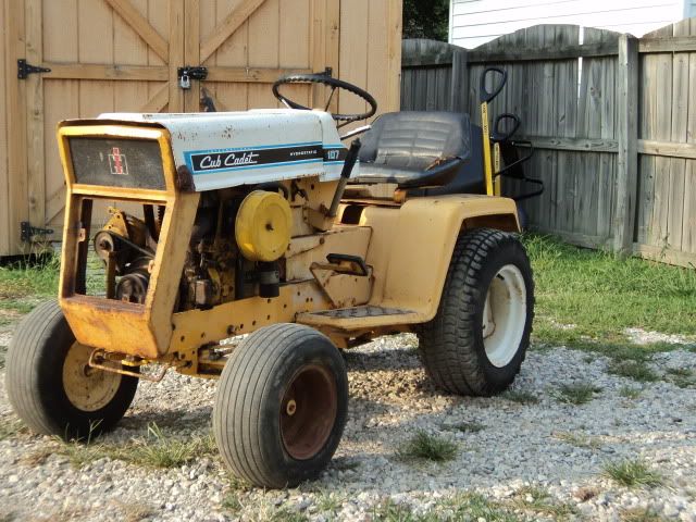

Default This is the Re wired cub cadet
Old 07-24-2011, 11:15 PM
Nice looking 107!
Old 07-24-2011, 11:35 PM
Nice looking 107!
That's Right!

Only bad part is it has a motor TAPing sound im hoping its just not geting oil to the lifters cause it only does it at low idle it goes away on fast idle im thinking the lifters arent geting enough oil. I put some Seafoam in it ima see what that does and if she is still tapping after the show looks like i got to tear into the engine
Old 07-25-2011, 08:02 PM
If the engine has the proper amount of oil in it, and the dipper is still on the rod, the lifters are getting oil. Check the valve lash.
It could also be the PTO clutch (most likely), sloppy driveshaft coupler, or any of a number of other things.
