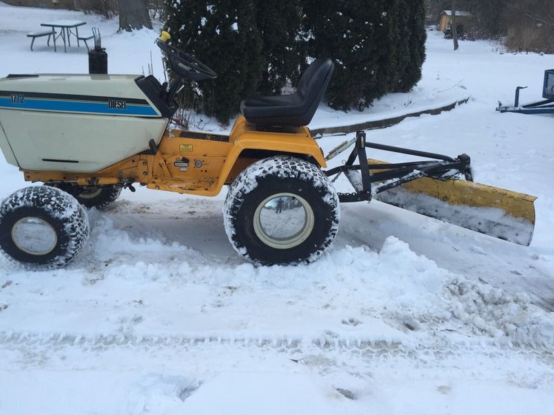

Maiden voyage, still need to get the H42 on the front. I'll have to fab up a lift link.
It needs chains, but I was surprised how much snow it would move with just bare tires. That rear blade scraps it right down to the concrete.

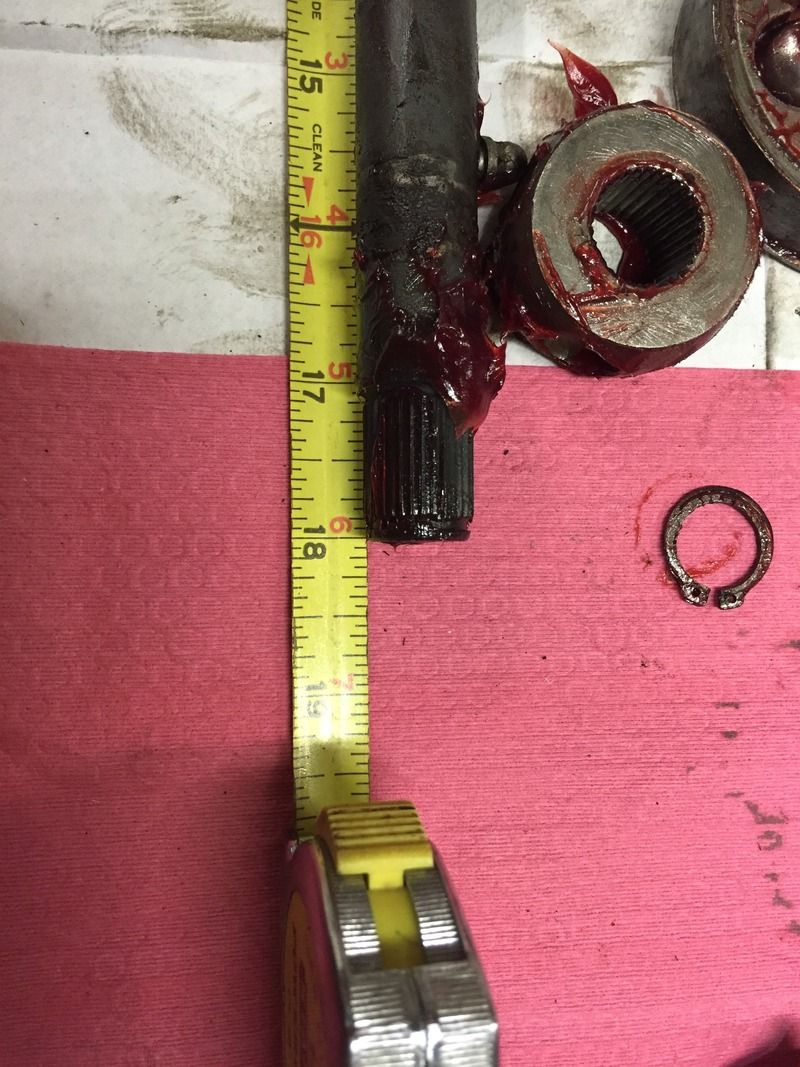

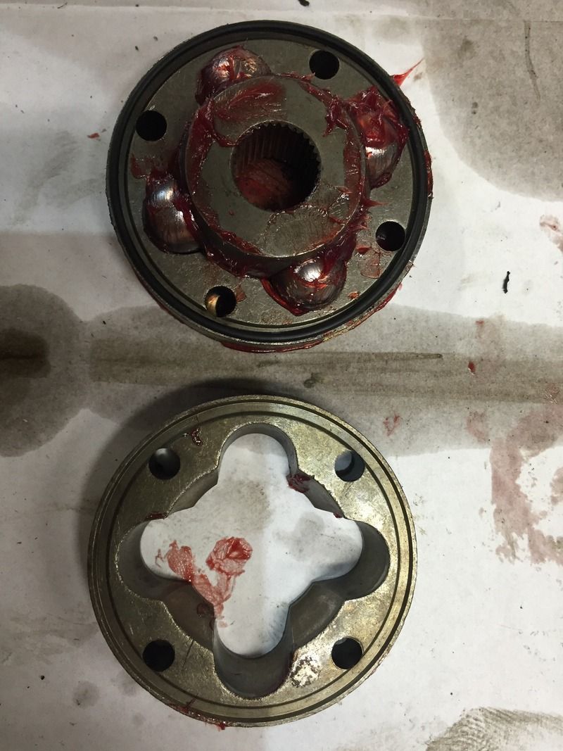

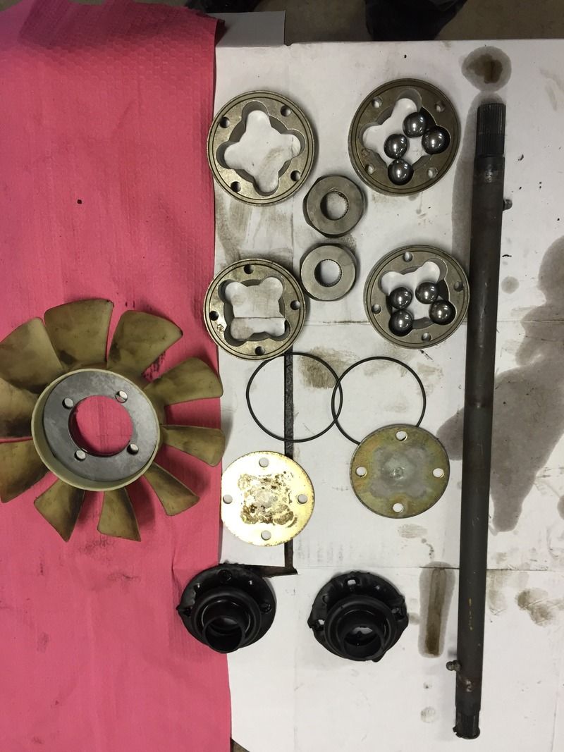

Got the CV parts out of the parts washer, and began to re assemble those;

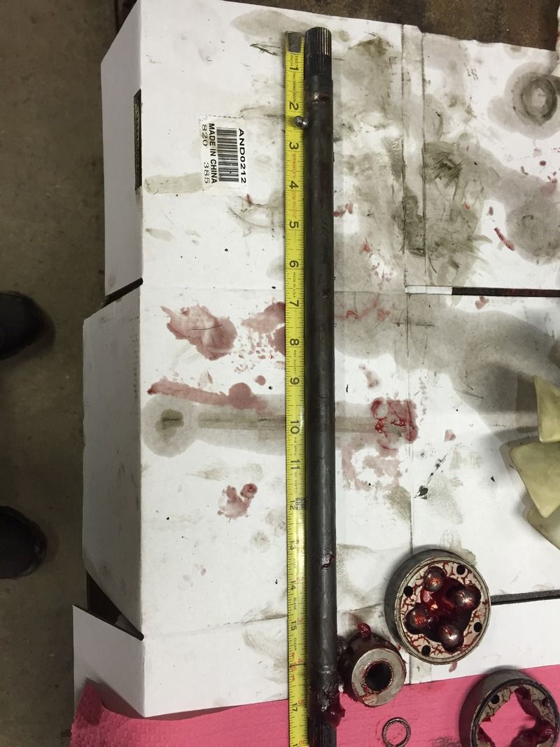

Everything was clicking right along, until I tried to finish the installation. It seems this shaft may not be from a 1864? It is about 2.5" too short
I pulled back out, it is 18.0" long, possibly Sam will chime in and let me know if this is in fact from a 1864, or a different tractor? Or I'm really missing something here.

This stuff about the drive shaft length is from an old post but I'll cover it again.
That is not an 1864 or 1863 shaft. Here is the info for the shaft you need.
Shaft, Drive, 20.38" Lg Part Number: 738-3098 ( 1863 &1864)
Jason drill and tap the pump shaft for a 1/4"-28 X 3/4" I use a right angle drill when I do them in the tractor. Just drill it till you get to the hole that the old spirol pin went in. Take your time because the shaft is hard and what ever you do, do not bust the tap.
