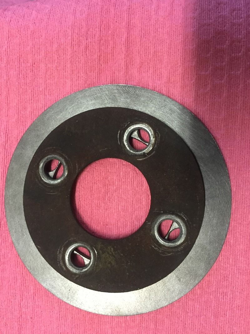

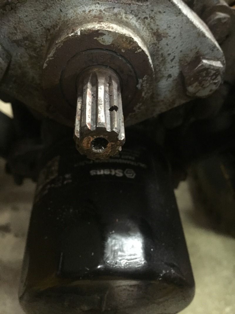

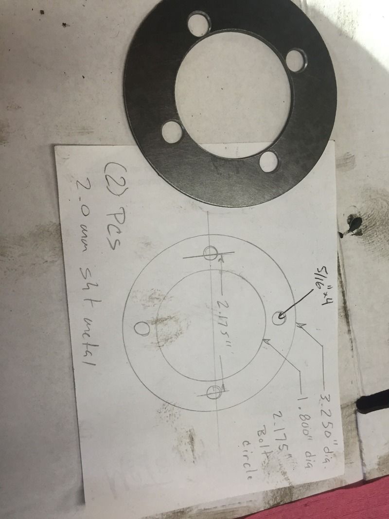

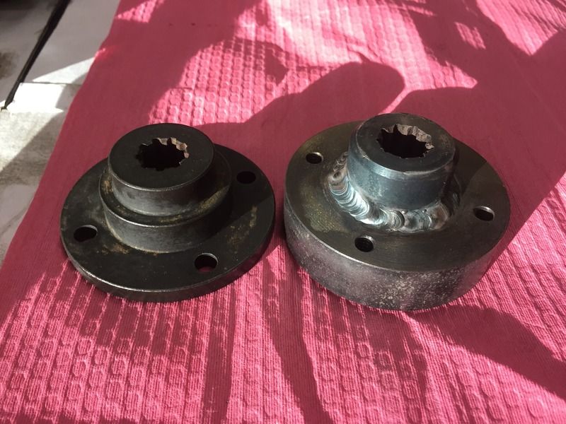

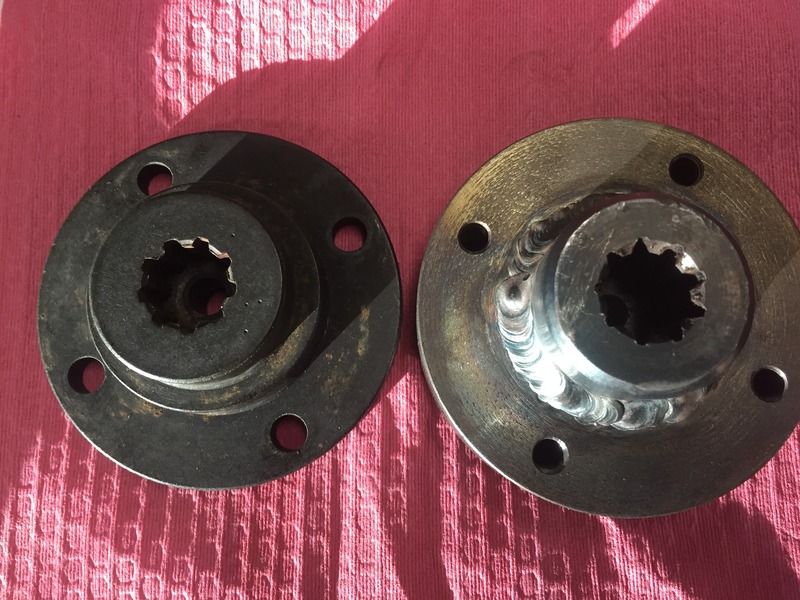

As promised pics of the pump input shaft;

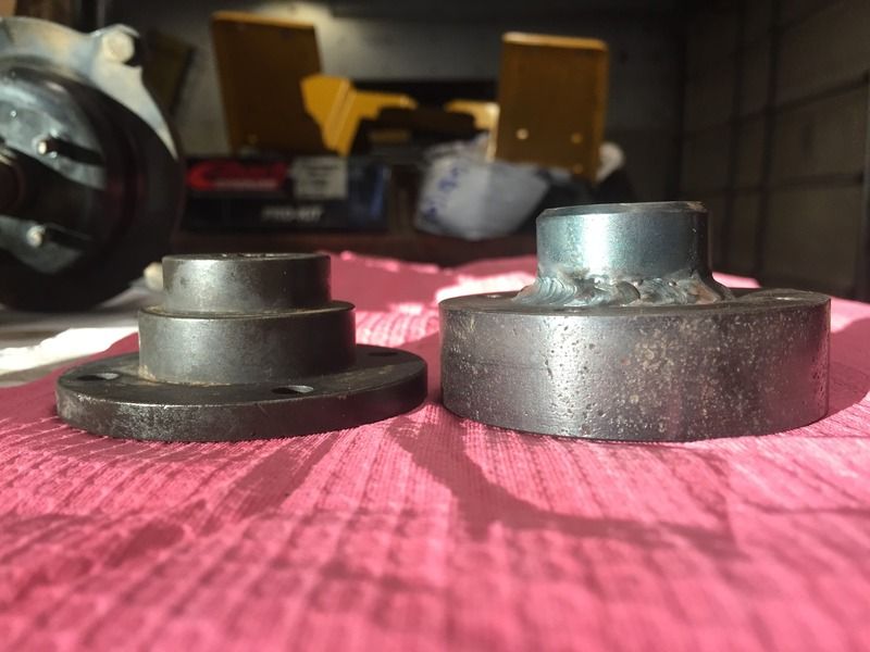

And the two adapters; I was wrong, the spline size is identical between the two.

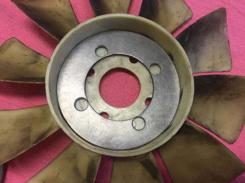

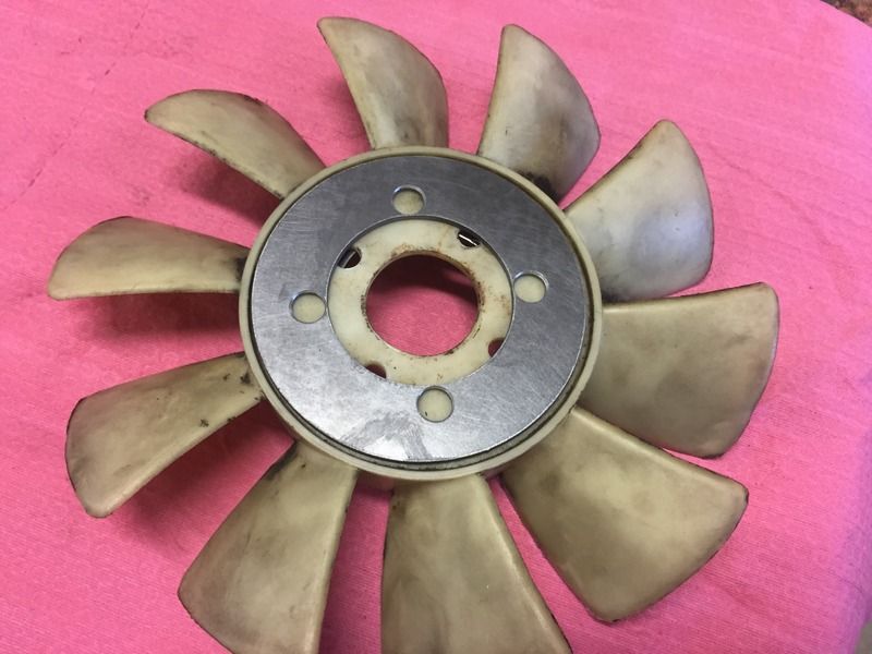

This shows what I am trying to do, to re use the fan from the 1772, cut out (2) pcs of 2.0mm sheet metal on the water jet. The fan will be sandwiched between those;
Difference in the bolt patterns;

Sounds like it's from a 1541. Who did you get the shaft from? Also you do not need to sandwich the fan between 2 pieces of steel. The fan plate I mentioned is one piece of aluminum. It centers the fan and holds the fan against the rubber CV boot. I like to keep the weight down that is hanging off the pump shaft.

Did you have Jeff make you a fan support plate? It will center the fan better than the shoulder nuts that the factory uses and it adds support to the center of the fan.
I do not believe he did?
To be honest I have not even opened the box he sent. I just asked for the adapters, so I am assuming that is all I got.
I was not aware that you had designed such a plate, therefore I did not know to request it.
I've sent Jeff the drawing so give him a shout, he should be able to make one for you.
Machined some up Friday night and mailed two to another OCC forum member this morning.
