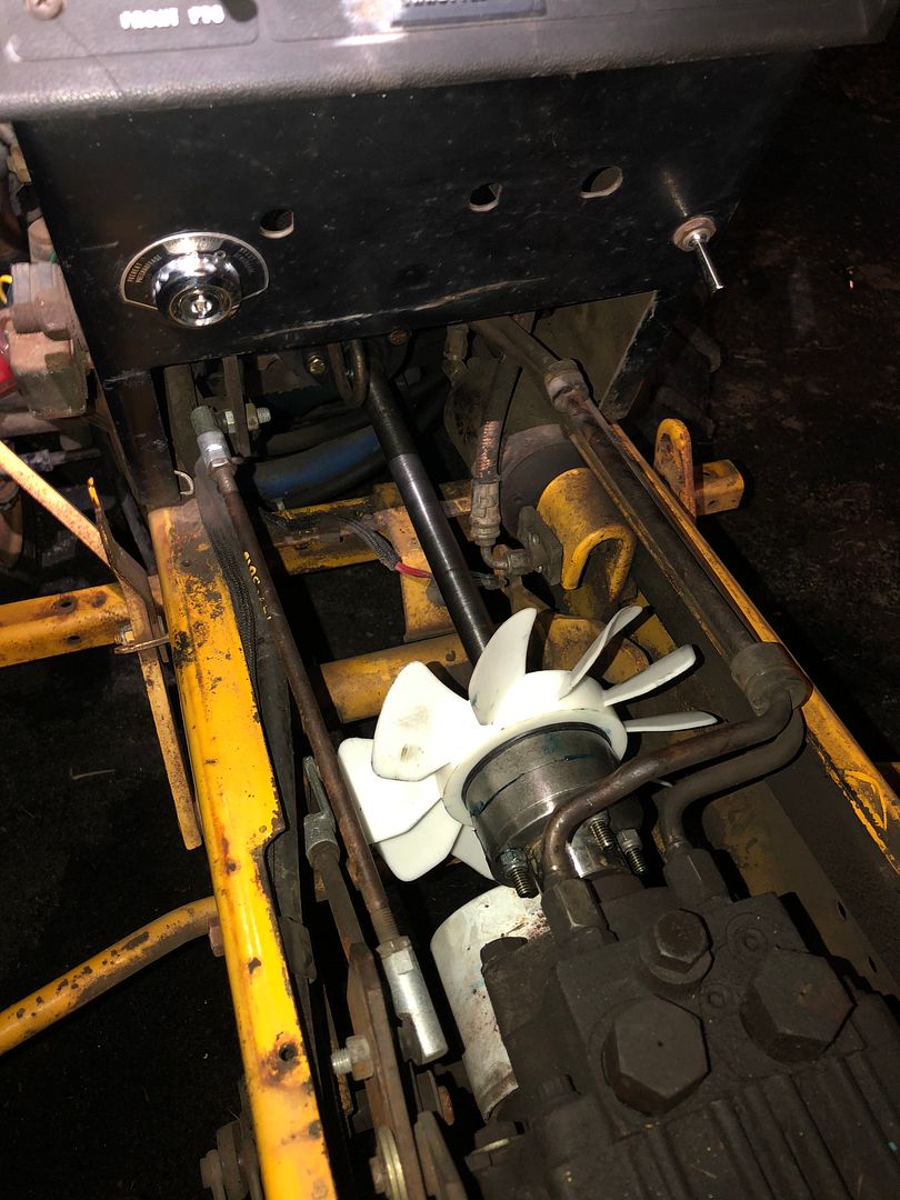

Some more goodies showed up today, One more step closer to a CV driveshaft.

Your shortened CV driveshaft ships Monday 3-26-2018
Almost there

Installed my new driveshaft today fits like a charm and also installed my new water pump belt.
