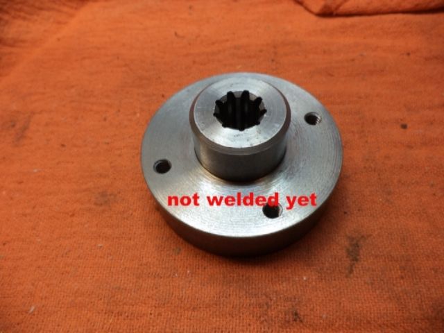

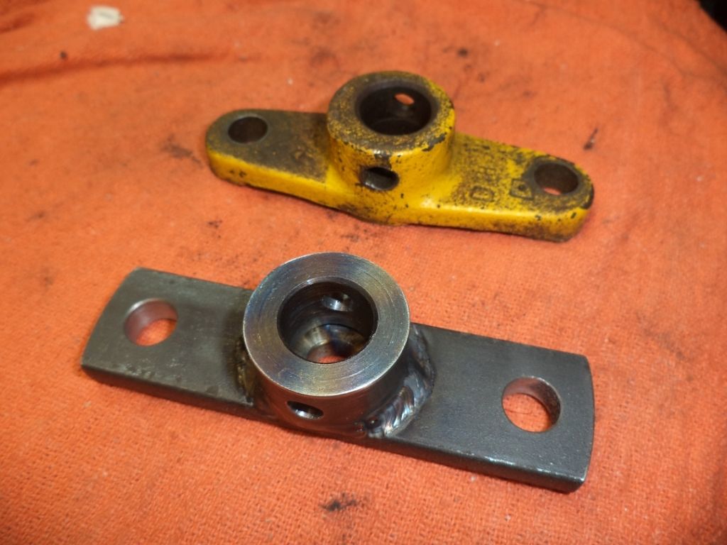

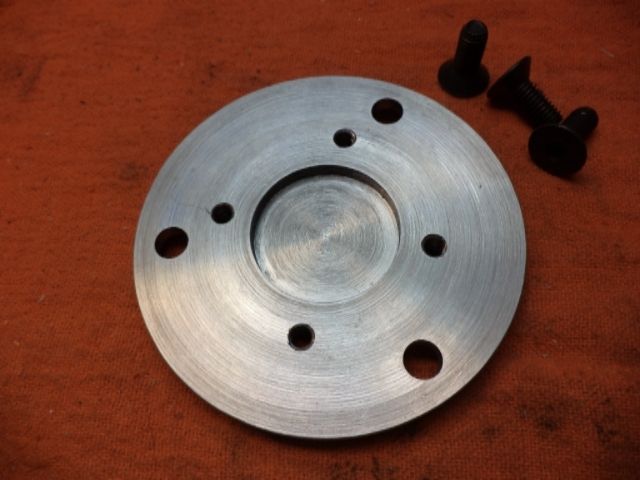

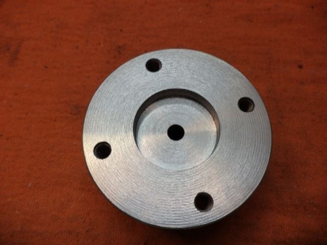

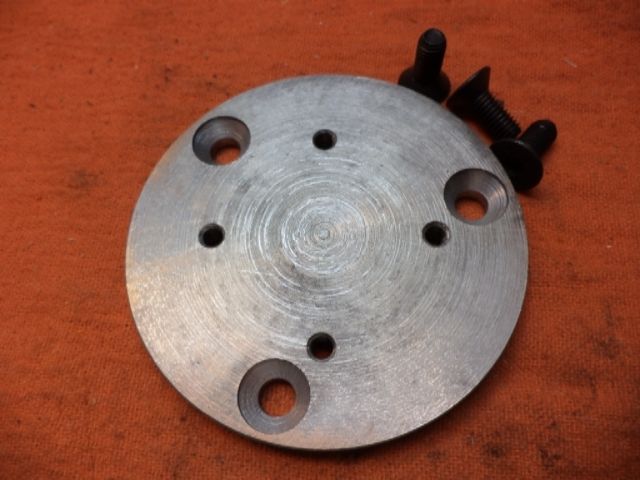

Looking at that pic Jeff, I don't think that is the coupler on the hydro.
This one is. It has the ball bushing removed.
  #112
Old 12-04-2015, 08:36 PM
Attachment 70219
The pictures of the two adapters are for the Kubota engine using a CV style driveshaft ( from a 1862 ) .
The coupler you pictured is for the factory driveshaft.

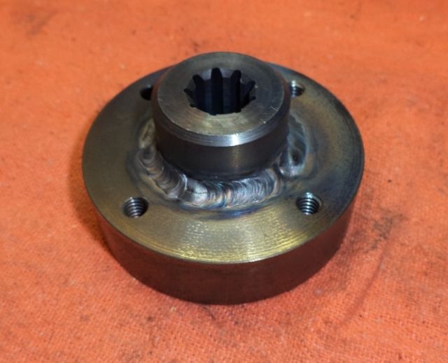

All that is left is to TIG weld the coupler to the hub on the pump adapter. The Kubota engine adapter is finished.
Looks great Jeff, THANK YOU. I sent the other part back, it went out in the mail 12/3.

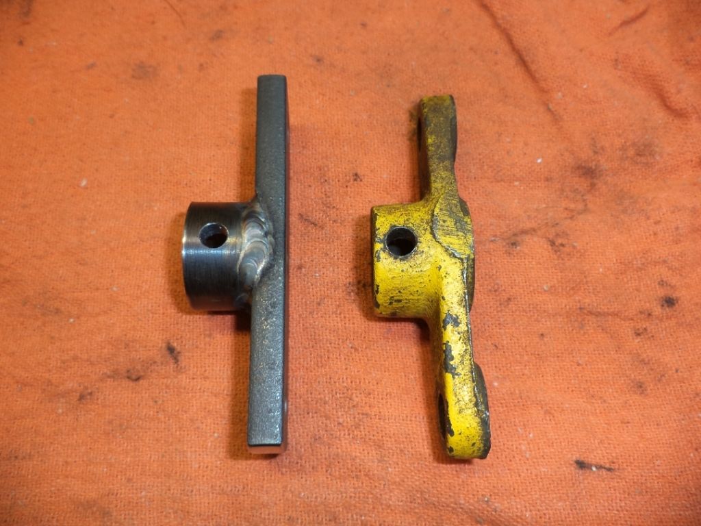

These?
or these?
I'm sorry Jeff, I was talking about these ones. Those look like the ones for the drive shaft.

Here's your splined hub welded
Yes, I agree too. A GREAT bunch of folks here.
Yes, NF & WF

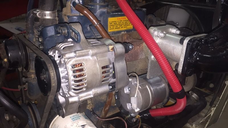

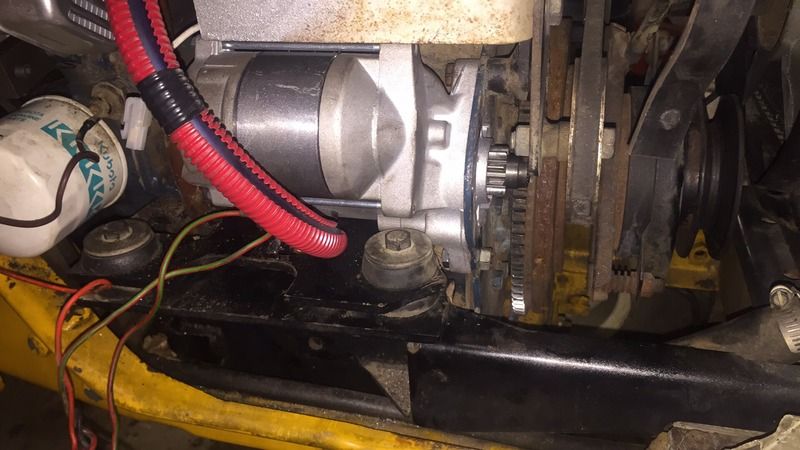

Got some work done on the 1772.
Gear reduction starter is installed;
As is the mini alternator;

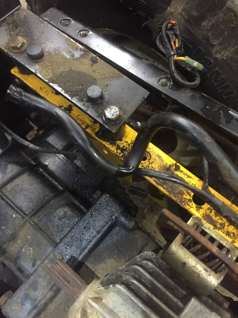

It has been a real pain to get this thing to start, the next day after the starter was installed, it would not fire up at all. I pulled the fuel line at the filter head, and energized to pump, fuel was coming out, but the flow was low. I pulled the tank and found the feed line was kinked. New lines will be installed.
I made new battery cables from 0 gauge wire and have to tidy the wiring back up.
The drive shaft removal was fun, . I need to pick up a replacement alternator / water pump belt, a new fan belt and new fuel lines.
The one snag I see is the 1864 drive shaft I bought, does not have a fan with it. If the one off of the 1772 will not work, I may need to source a fan. Other than that it will be going back together.
