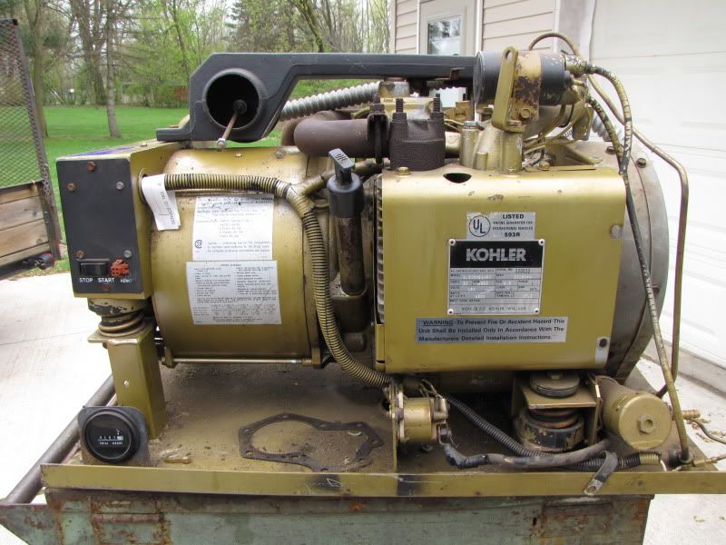

I'll need to install a fuel pump, though, since the fuel tank is in a different place.
Some where I think I posted a picture of the Kohler generator that I used for parts, on my rebuild? Anyhow, that thing had a small 12v fuel pump on it. If you want to go electric let me know, I'll try and dig it out of the scrap pile.
We have a trailer load of scrap ready to go to the recycler, and it is in there. If you want it, I'll text my son and make sure he does not haul it today.
I'll hold it for you. You cover the cost of shipping from 48507 and it's yours. The thing is small, it may fit in one of those USPS prepaid boxes?
Lower right corner of this pic;
I also have a standard bore cylinder, I did not use. It is not scored, but had a little rust pitting in it, it may be fine, but I did not use it. It's not on the scrap pile.
