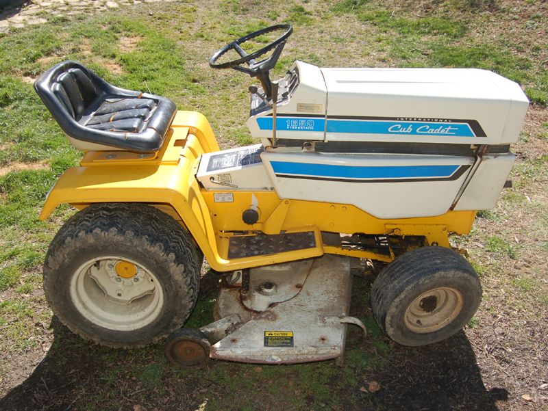

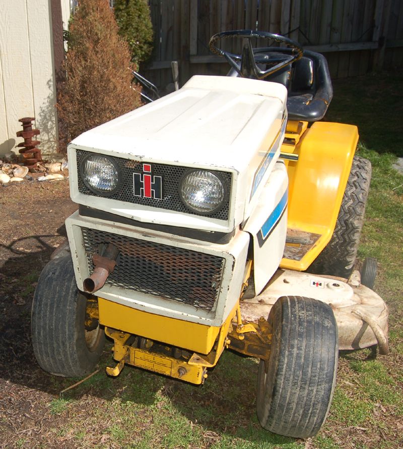

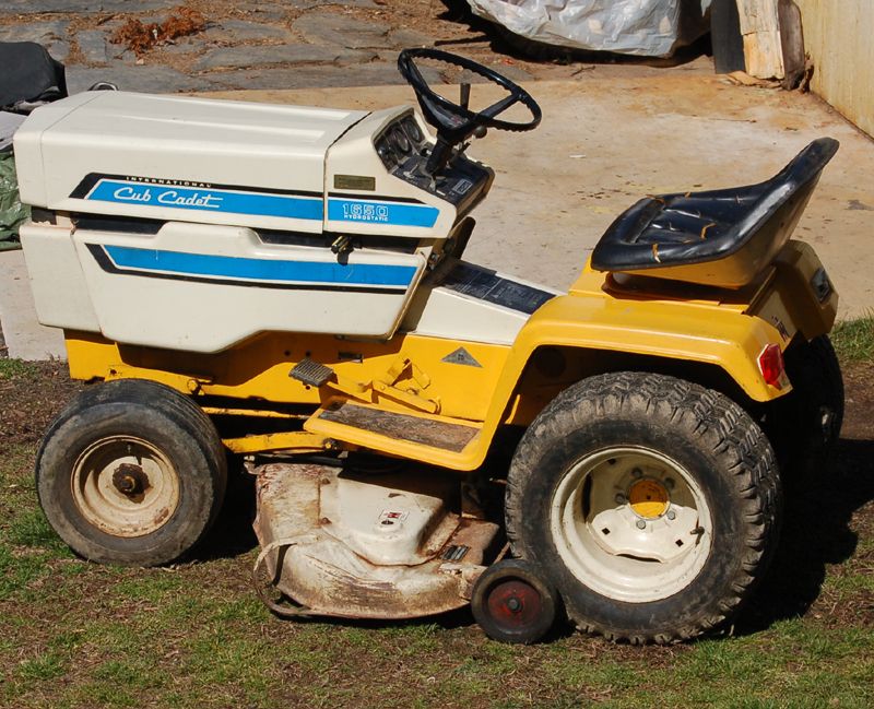

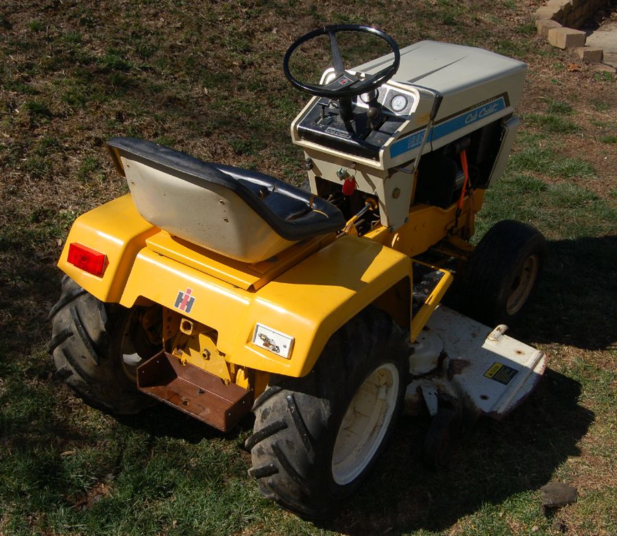

just picked up a 75 1650 for basically free.......got her all cleaned up and got her running. Moves forward and back, PTO works...need to do ISO mounts and cooling fan. Trunion and rag joints look sweet.......issue i have is the lift lever moves foward and back, but nothing happens.....searched here and in the manual i don't know where/what to look for...troubleshooting tips?
pics for you guys..

pulled the firewall off, forgot about the ram on the column....wouldnt budge..2 shots of kroil, and a little plier jiggle, she moved.....put back together, and it up and down
here it is all washed up..(covers and hydro cover not in place due to needed repairs)
i swapped out the tires with ones i had..i really want to paint it ih red..but this thing is in such great shape....not sure
