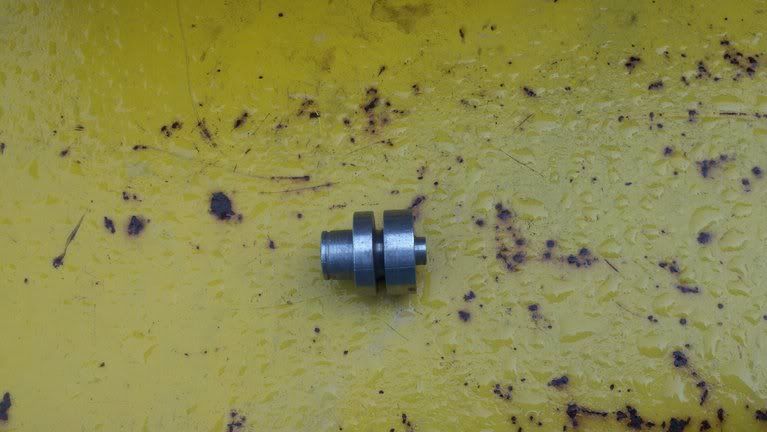

Well I got my parts yesterday I was hoping you guys could take a look at this PTO thrust button and let me know if it's the right one for my 149. I am sure the fiber button I got is right but I'm not so sure about this one.[IMG][/IMG]
Thanks,
Bob
