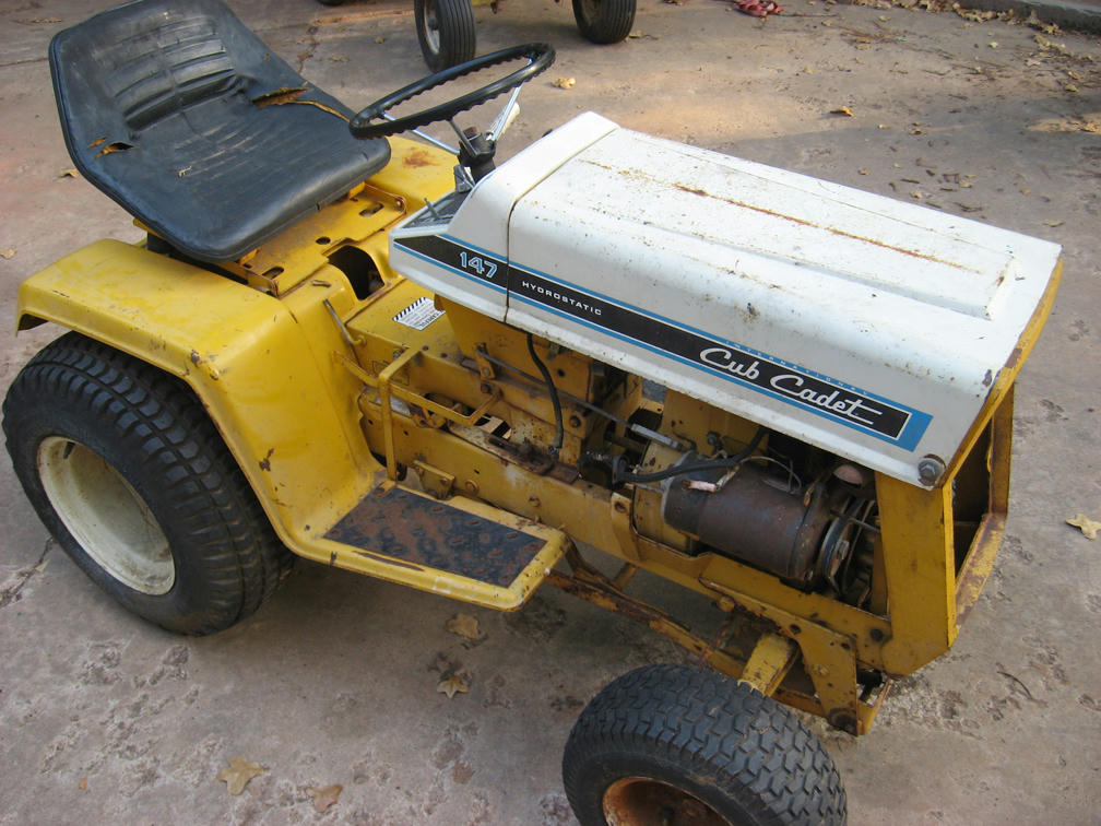

Inspection cover behind the tunnel missing, semi-circle screen missing from over the drive shaft. Sheet metal is actually in very good condition. Minor pitting on the hood, and no rust in the tool well below the seat!

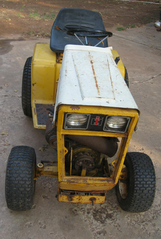

Front grill insert gone. Axle in fine shape, mower carriage present and in good shape.

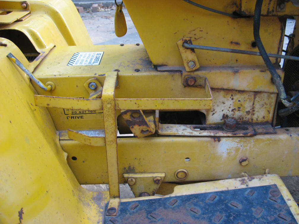

This is all that remains of the electric lift. Valve release lever seems to be doing nothing. Machine can be moved only after a day or two of sitting.

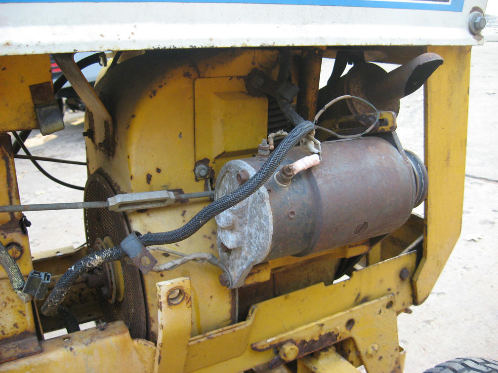

Wiring is awful, will need a complete replacement harness. S/G works and charges, although it's a bit draggy.

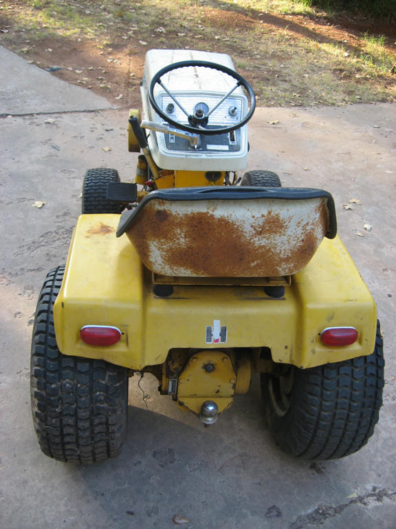

Original tail lights I believe. Set pan is salvageable, IF I can find the right replacement cover. Rear of fender pan looks rough, but I think it will turn out just fine. Free trailer ball hitch! Tires hold air, but they will all go eventually.

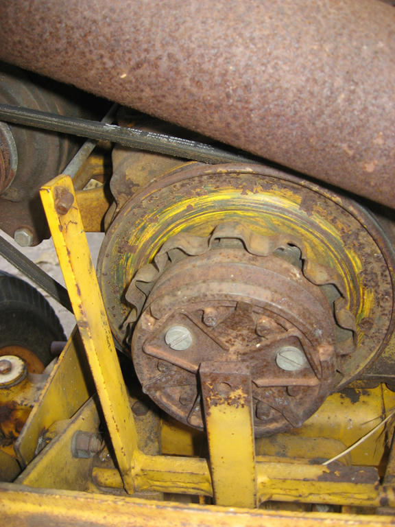

PTO is all rusted together. Dunno if a rebuild kit will do anything for it. Looks like something is missing off the manual lever/actuator?

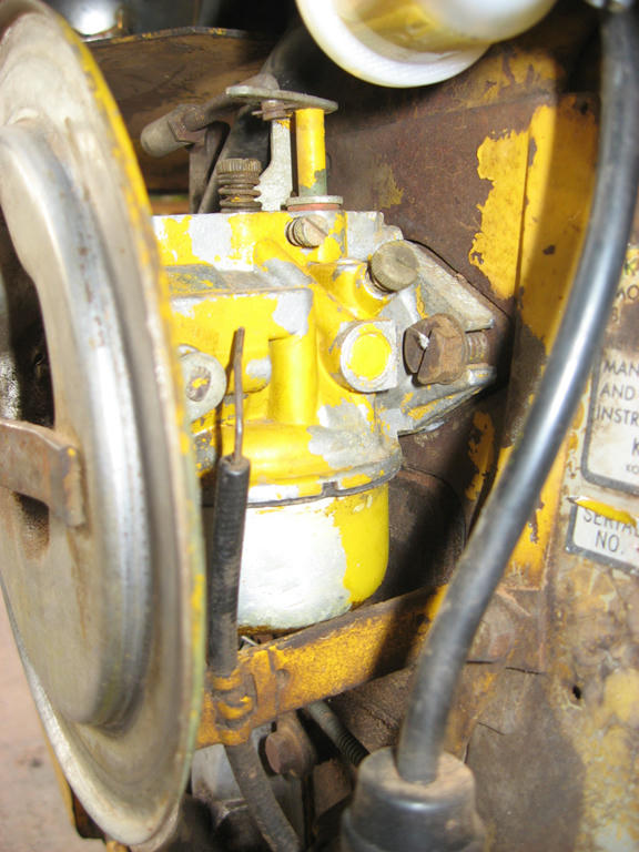

Looks to be the original carb. Choke disconnected and frozen up.

Hey, it appears that the spindles on your front axle are the older style? I have a 147 that has the new style like the quietline. Did they change types somewhere along the way during production of the 147's, or did someone likely just change this one, or mine

Sharp eyes.
I couldn't begin to tell you, but the Cub gurus around here will. It's possible the PO of your machine bent one, then replaced both with what he could find, ie: from a Quiet Line.
