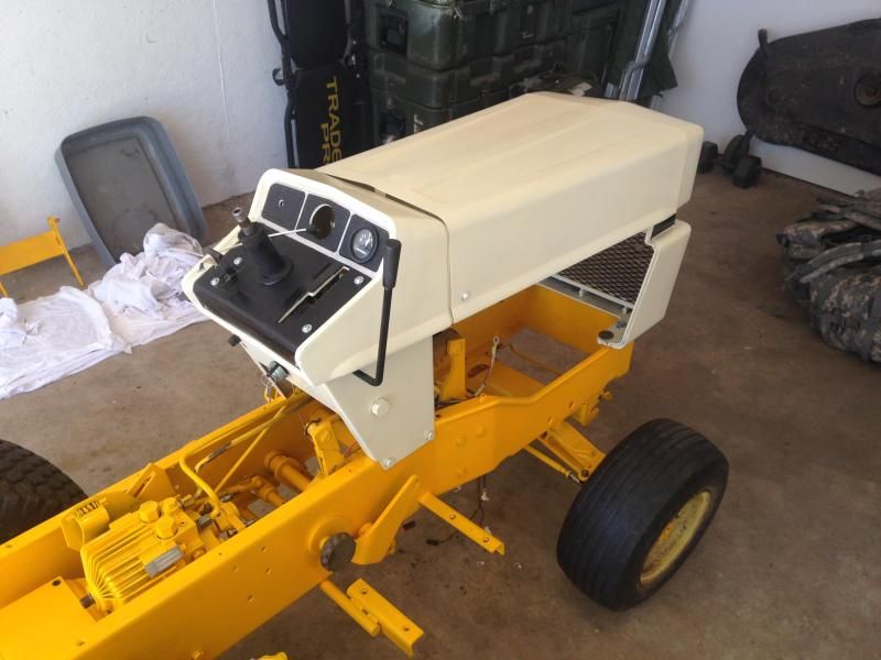

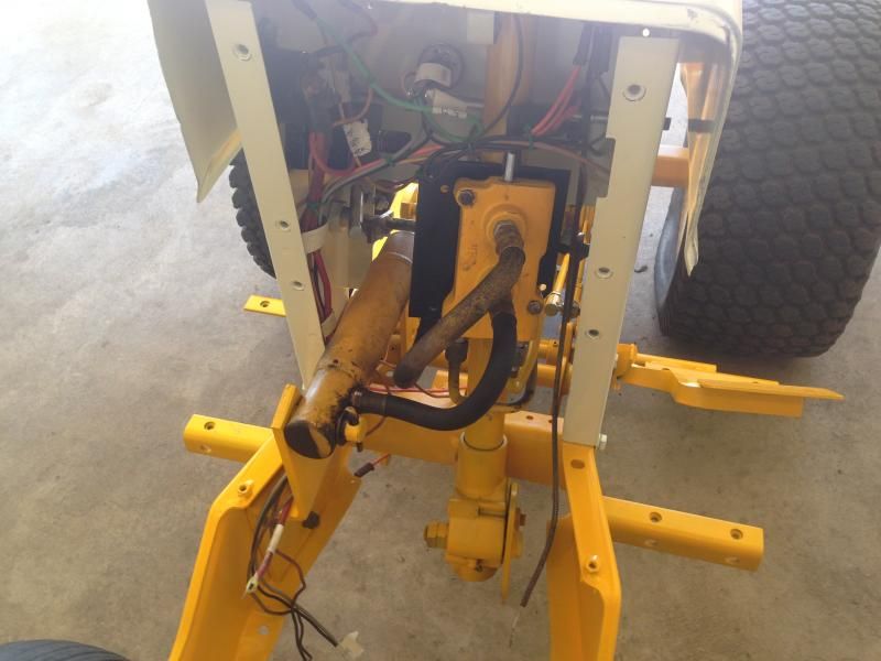

Got some more work done, it is slowly resembling a garden tractor again.
Quick question though, has anyone had an internal brake pad pop out. When i pulled the cover off during teardown, there was a little puck that i thought was a magnet (like in some oil pans). Turns out it is a brake pad, but i cant see how it would just squeek out of there

Looking very nice.
If your guy hasn't started on your fender pan, you may want to reconsider blasting it. Work-Hardening isn't much of an issue on thicker parts such as the frame, but blasting tends to leave the thin stuff a bit brittle.

Got the chance to do a little more work this weeekend. NEVER AGAIN will i use rattle cans. This was my first tractor job and i thought by the size i would be looking at a few rattle cans, boy... was i wrong. Anywho, just waing on some other little pieces and finishing up some paint.
Next weekend i will slap the rest of the sheet metal on, square up the linkage, and give the carb a bath. I was going to pull the whole engine apart and rebuild, but time is becoming of the essence (plow season). So i will run it until spring and tear it down for a good overhaul.
Last thing, has anyone had any luck with that $10.00 seat cushion from colemans. Its probably a unicorn that sells blinker fluid, but maybe someone has some input.

You did a remarkable job rattle-canning those fenders. It's just about impossible to get the paint to flow out fast enough on a piece that big. You are right on about not going that way again. Nothing magical about spraying with HVLP. It's just like a big ol' rattle can that doesn't run outta paint as soon!
