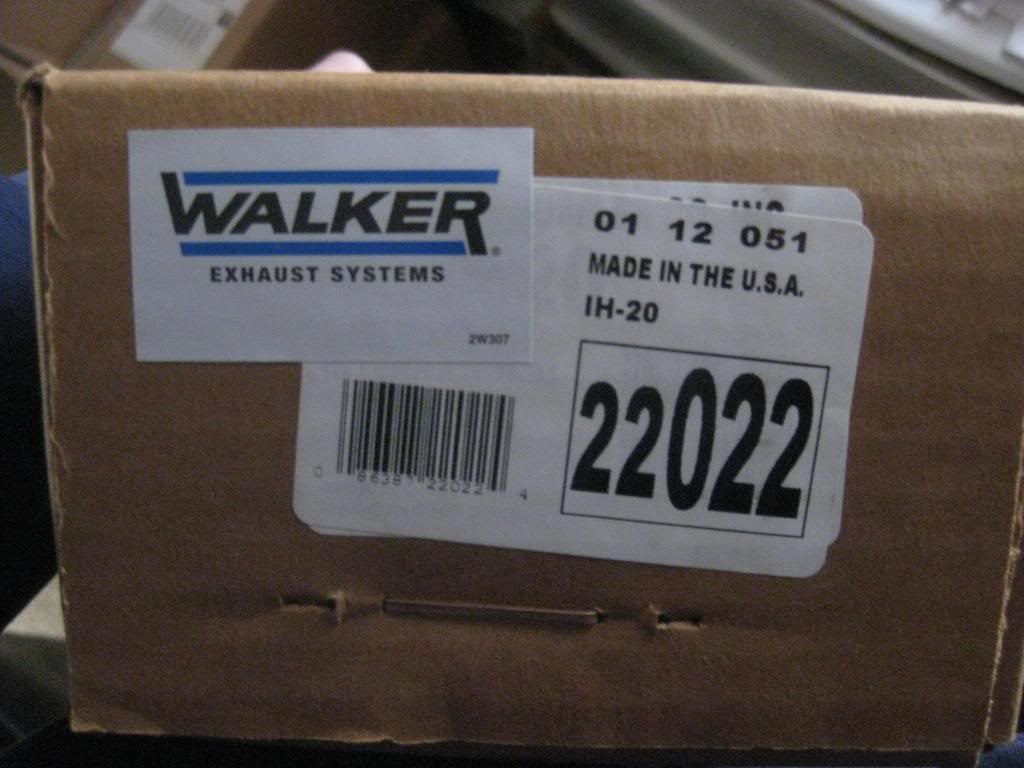

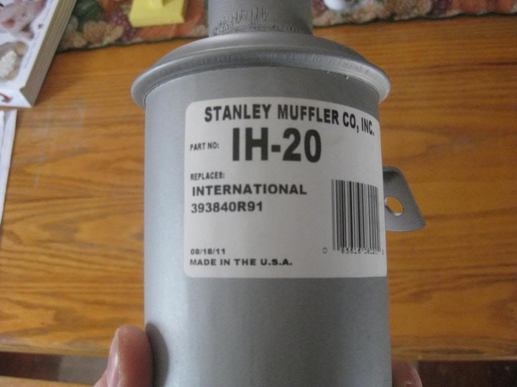

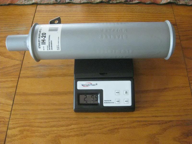

I got it in the mail today--$36.82 from Rock Auto with coupon code. It is actually manufactured by Stanley Muffler, part number IH-20, but it did come through Walker and it is still made in USA.

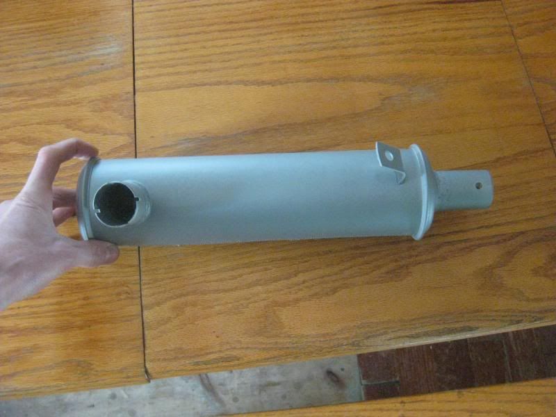

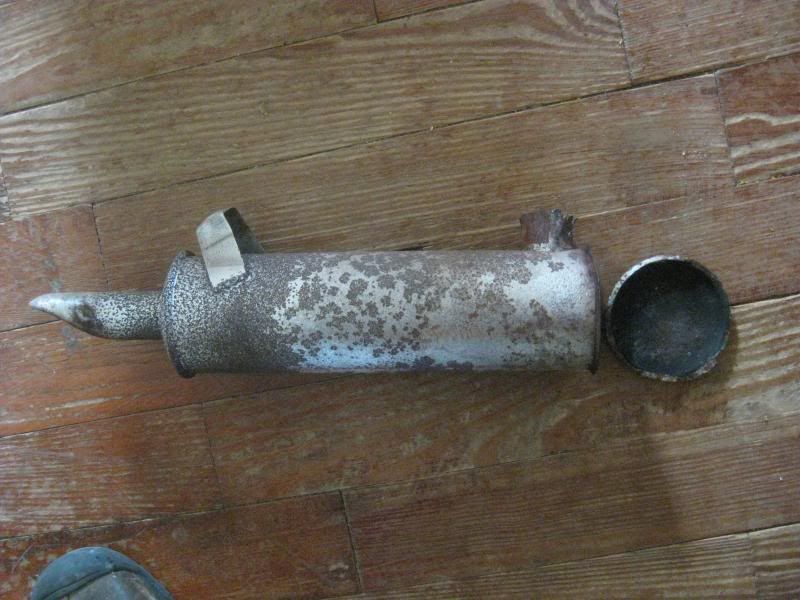

The new muffler weighs 2 pounds, 9.9 ounces. It feels like a quality part and looks like it was welded well. My old broken muffler weighs 1 pound 10.4 ounces.

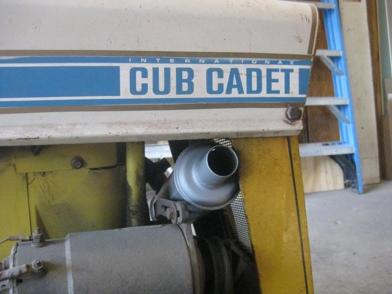

The output is kind of disappointing because it doesn't have the downward bend and angled tip like the original ones. I park it in a shed so it won't really matter, although it does tend to shoot exhaust in your face if you are standing next to it. If your cub lives out in the rain then this is not the muffler for you. It will allow me to add on my own end piece though, and I think I will try to make one that points the exhaust forward and down.
The bracket near the output end does not have an integrated nut the way the original one does. That's not a big deal though because I have lots of nuts lying around and it wasn't too hard to reach in with a wrench to hold the nut. Otherwise it fit without any problems.

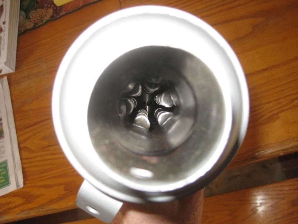

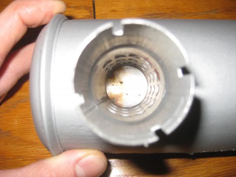

The internal construction is different than the original one but I am not a muffler expert so I don't know if it makes much difference or not. It looks like this new one will have less back pressure since there is a straight tube all the way down but maybe this will make more noise than the original design.

Here are some photos:

It sounds great with the new muffler!
  #24
Old 11-14-2013, 03:48 PM
Thanks for the update on this. It def. sounds way better with the walker muffler. When I viewed the first video I wasn't sure at first what noise a cub could make to sound like a chicken until I saw it. I'm disappointed that the walker doesn't have the same end as the stock muffler; that tip design is part of the reason why I like the original muffler (design).....
