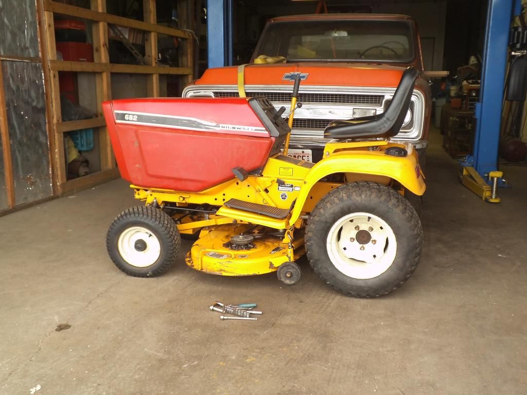

Originally Posted by inspectorudy View Post
Has anyone tried to adapt the old steel panels to the plastic panel tractors?
There was a guy on facebook that put 82 series sheetmetal on a cyclops and he said it was a direct fit.
Found it. This is a 1440.
Take a closer look at the dash, you have to swap out the dash towers as well to make it fit.
I am pretty sure he had to change the dash tower and the steering column as well.It is not a cut and dry swap but will be doing the same conversion on my 1641 this spring. That looks so much nicer than plastic junk that was on there.

Yeah, I saw that. Hydraulic lever, among other things, is a dead give away. Still not a bad option though.
Here is his before pic.

It looks like the spool valve needs changed too. Will that work on a tilt column?

I'm in the process of changing a Cyclops over to the 82 series sheet metal. The dash towers are definitely different. I'm doing it the hard way. I'm modifying the Cyclops dash tower to accept the 82 series parts. This way I'll retain the tilt column and the Cyclops hydraulic controls.
It's been a challenge, but I think the end result will be worth the effort.
