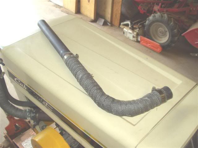

This what was on Son's 86 in the picture:
The exhaust pipe is longer in the first picture. An old hot rod trick I learned years ago is to paint the exhaust pipe with cheap paint and run the motor awhile. There will be an area where the paint quits burning off. That is the area where you want to cut the pipe. In theory it is suppose for the motor to make the most power.

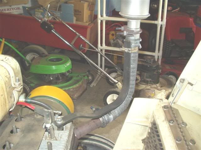

This muffler is from a Cub tractor:
Another view with brace on it:
Some may be wandering what the tape/wrap type fabric is on the exhaust system. I think the product is called Header Wrap. This wrap keeps the heat inside the exhaust. It aslo helps keeping decals from melting.
The motor has around 30 hours run time on it. Decals still look like new.
I would stay away from a stack. You will have problems mowing around trees....not worth the aggervation.
This tractor is used for pulling and plowing.
