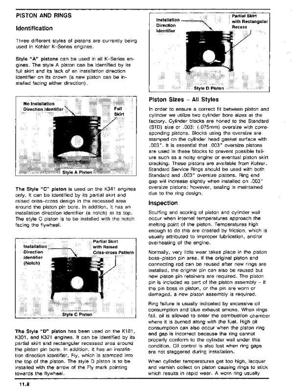

I am getting ready to install the piston in a k341 I know the connecting rod needs to be facing a certain way, I got that. There is a little machined divot on the surface of the piston does that have to be facing a certain way as well?
I was going to use the old piston and connecting rod as a guide but the I remembered that the P.O. swapped the intake and exhaust valves in the motor so I figured I had better ask somebody who knows more than me before I install it.
Thanks

From the Technical Library.

Thank You!!
I hate to go though all the trouble of a rebuild and install the piston backwards!!

Just curious,
Which piston are you using?
A, C, or D?
Old 10-27-2010, 08:06 AM
angry1 angry1 is offline
Join Date: Apr 2009
Location: MN
Posts: 46
C style piston I have the notch cut out on the piston head and criss-crossed recessed area under the top of the piston.

The infomation for which way your piston goes can be found in our Technical section:
http://www.onlycubcadets.net/forum/s...ead.php?t=4646
