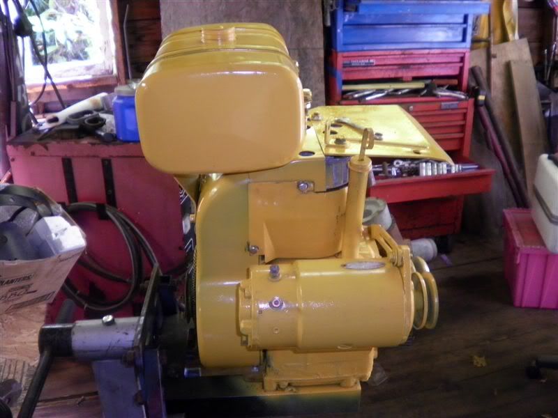

OK Matt it's my darn dyslexia showing up!It's a 125 the one with the Danco loader I also keep mixing up the 582 and 682 as in which is hydro.The dash is being repaired on the 125 so the model # is missing and I guessed! And now I'm guessing that's why my search didn't work also!Here's a before pic IF I did this right!

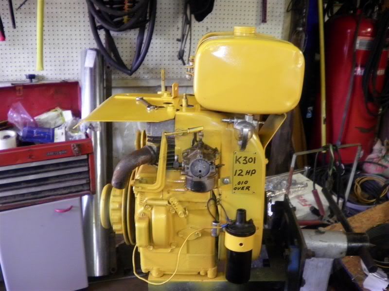

Where would the port taps be in this picture ?I just looked under his machine and I don't see these pipes. Reaching up I feel plugs there,There are also 2 plugs in the bottom of the trans below the filter pointing straight down at the ground.Sorry for the dumb questions but these are my first Cubs and I'm learning every step of the way!here are a couple pics of the engine waiting on my stand
I've also had the loader blasted and painted it and cleaned and painted the tractor but it's a just spay bombed for now!the note on the tag is because you can't read the tag from the POs "care"
