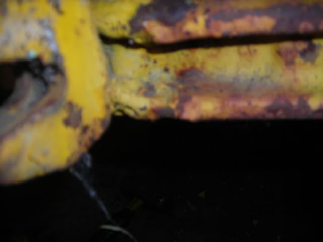

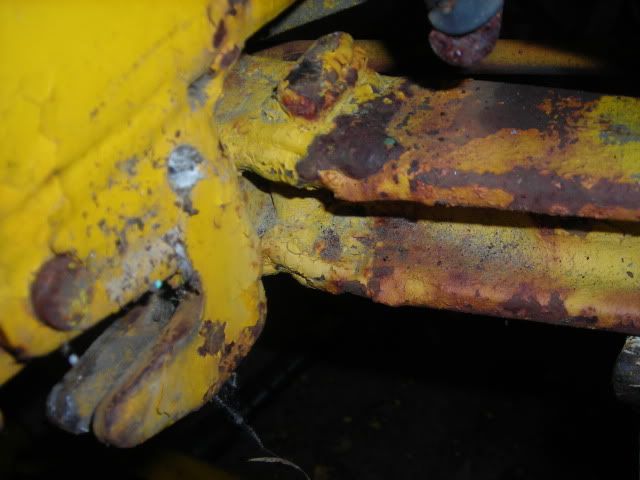

Would a wide frame (1450) front axle work under a narrow frame (147)? Would there be any benefit? I'm just looking and thinking. Haven't had time to measure anything yet. The front axle on the 147 has been welded.
If it won't work, it's not really a big deal. I do have access to another narrow frame front axle, but I would have to pull the engine to get it. The 1450 already has the engine out. Thanks.
