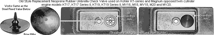

I am trying to do some maintenance work on the tractor but am having an "oups" moment because I removed the cover for the crankcase breather valve and mine seems to have some kind of metal umbrella valve in there (as opposed to the rubber one I see on internet). I should have taken a picture before removing it from it's place but forgot! Now I wonder on what side I should put it...
I think it's the wider side down (as in the picture I just took) but am not sure.
Also, should I force it a little so that it sits in the metal base or just leave it loose on top of it?

I did looked through the manual and all I see is the rubber model and mine is metal... Maybe it's not factory, IDK... From the shape of the rubber one though, I think I should put the wider base towards the engine and the smaller base up... Will continue to research... I know there have been a redesign of the whole assembly that has a reed valve (which is not the one I have).

I think I just figured out looking at the parts diagram... From my understanding, I have the "old" model breather valve and so the metal valve I see is the one in which the rubber umbrella valve (missing when I opened the cover) is supposed to be!

Yes! I've ordered the new updated metal plate that comes with the reed valve built in... The project of getting this tractor to run smoothly has just become more involving! haha! I hope it doesn't snow a big storm in the next few days as it's my snowblower!
