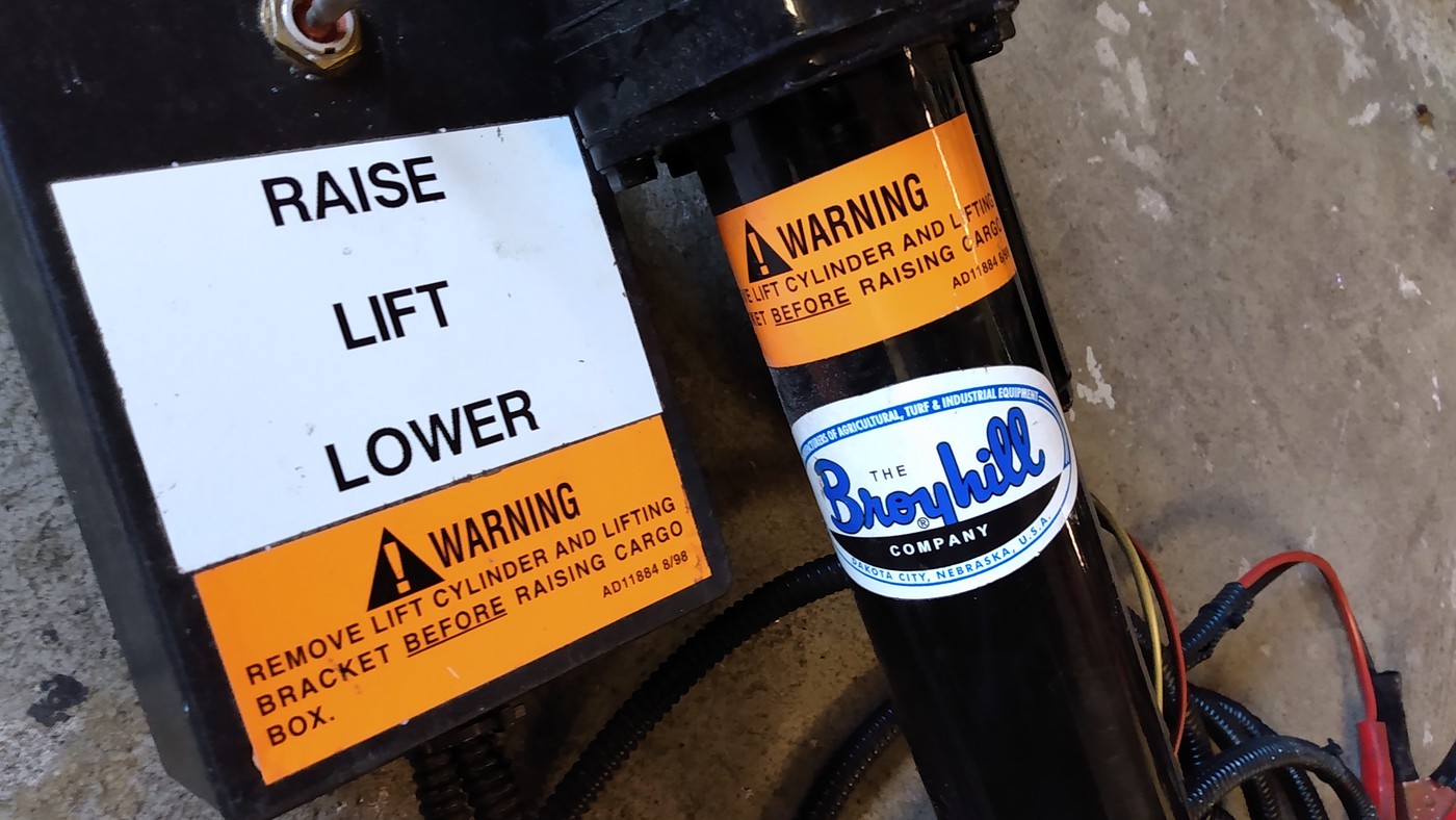

I have a very heavy duty electric linear drive to lift the deck
This came with the CC782 I picked up and refurbished last month.
