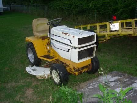

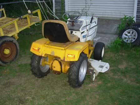

Well, it has a hood in dire need of sanding and painting. It is missing the engine side panels. The dash is a complete hack job. The fenders and foot rests are also in need of some serious work. I will get some pics for ya'll. I took some of my 1200 the other day. I will try to post them tonight. I will get some of the 1450 tomorrow if possible.

Be ready for a fight if you pull the hitch to swap it....I took the rear hitch off my 109 tonight, and it was a struggle all the way. The pin that goes thru the frame and the casting was seized in both frame and casting.....Major heat, carefull hard hammer blows, and lots of PB Blaster and it eventually came out.. Tractor had to be stripped of all rear sheet metal, and both rear tires to do it. Once it is all cleaned up it is going to get a good layer of grease before it goes back together...might even install grease fittings if I can figure out where. If yours is new enough to have the "frankenstein bolts" it should be easier to pull the hitch.
As far as sheet metal goes.....the guys who strip cubs usually have a bunch of saveable fender pans around as they are a pain to ship.....I picked one up off Ebay last year 5 miles from where I was for work....$5.00. And you can use a 1x9 series hood, I have one on a junker 1250 up in NY.
Interesting rear tires on the 1200..they look like a rice and cane version.

I work as a diesel mechanic and we also have a tire shop. The boss does a lot of ag tires. Those are Titan Tru Power 6-12's. I got them for $20 for the set already mounted. Could not pass the up. I will get something a little wider later.
