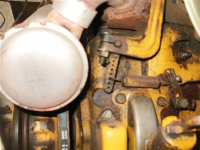

This is the correct setup for your 126.
The holes that spring are using may be different on your Cub.

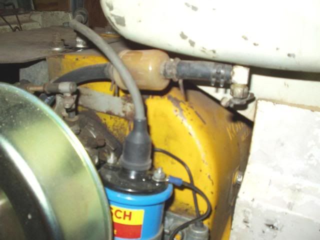

It looks like the linkage going to carb is rubbing against the fuel line hose.

Same tractor-different view:
