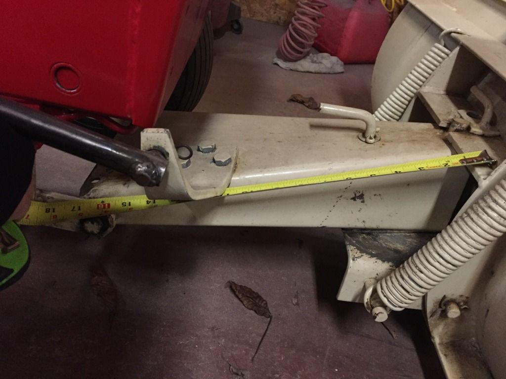

Wondering if someone could give me the dimensions for the "a frame" for a front blade mount for a 1250.
What I am really looking for is the pin to pin distance front to back for the A frame. And the location of the lift bracket.
I am adapting a 42 inch blade from another brand tractor and basically have to make the a frame between my blade and the cub under-frame mounts. I have some 1/4 inch plate that I can weld together to mimic the A frame as it needs to mount to my blade. Trying to figure how far out in front of the wheels the blade needs to go, and to not overstress the cub mechanism by making the A frame too long.
I know I could get a cub a frame and cut/weld it to fit, but I already have the steel laying around (and no cub A frame unless I buy one!) And the front attachment for my blade is different from the cub design...
Thanks in advance!

Hope this helps. Looks like about 16".
