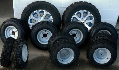

Most of my cubs have atv tires. I buy them on craigslist. I can buy a set for under 100 for 4. I set a paid 20 a pair 1/2 worn which has more enough tread on them and a set brand new take offs for a 100 for 4.
