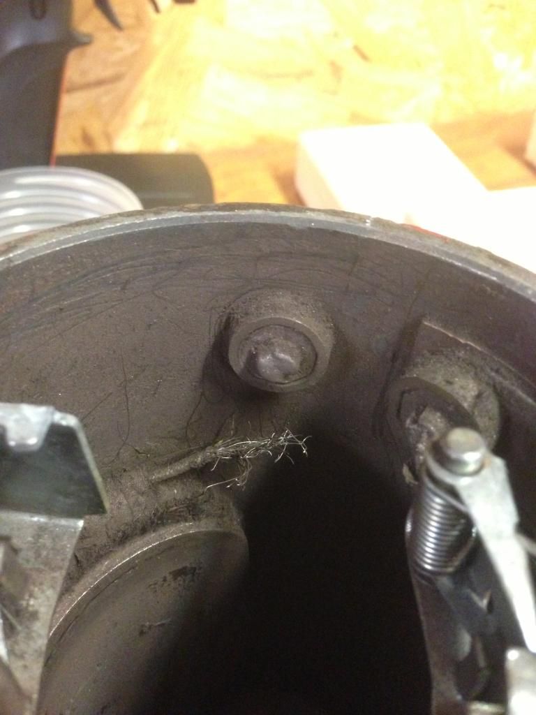

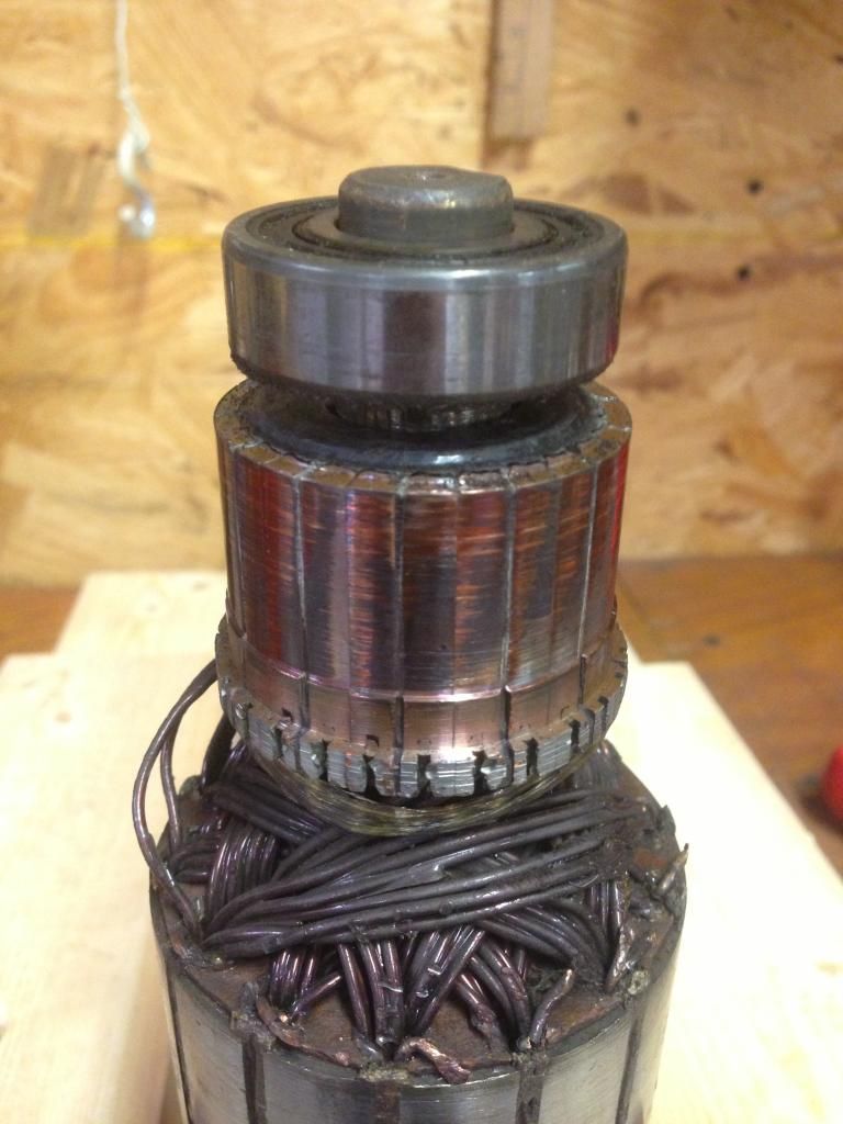

I went to start my 129 yesterday and got nothing but a click from solenoid. Pulled out the meter and got 12V at the "A" post on the S/G with the key in start position. I opened up the S/G and found this.
Half of the windings were gone from between the commutator and armature. It almost looks like it was over-revved and the windings pulled away from the comm. It also took out the wire between the field coil and the "F" post.
I picked up a parts S/G to use the armature. I'll fix the broken field coil wire and hope to get it working again.

I got the S/G fixed today. Just so you all know, parts interchange between the Delco and aftermarket S/Gs. The armature came from a Delco and fit perfectly in my knock-off S/G. Now, I need to pick up a new belt as the one I took off was completely shot.
