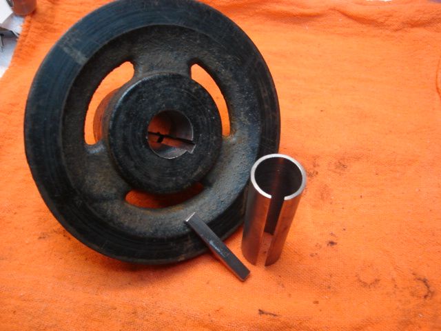

I can fix that pulley. I'll bore the pulley out and recut the keyway. I'll make a slotted sleeve and a custom keyway.
This is a tiller pulley I repaired.
It will cost $50 plus shipping so if you can find another pulley to use, that's OK too.
