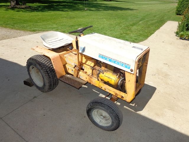

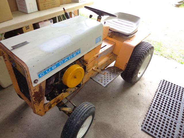

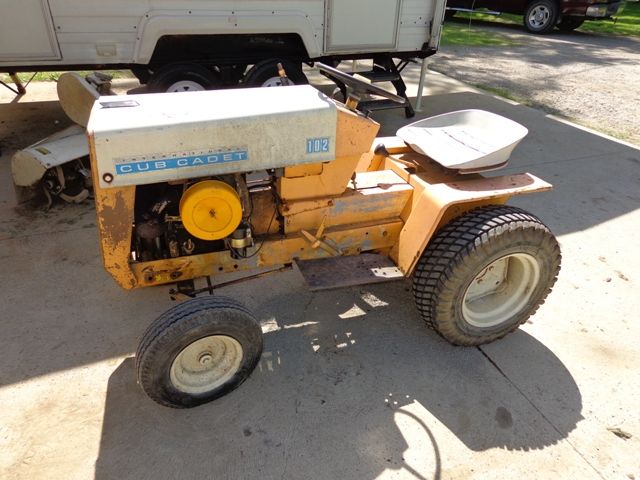

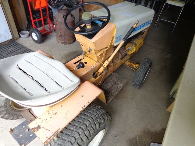

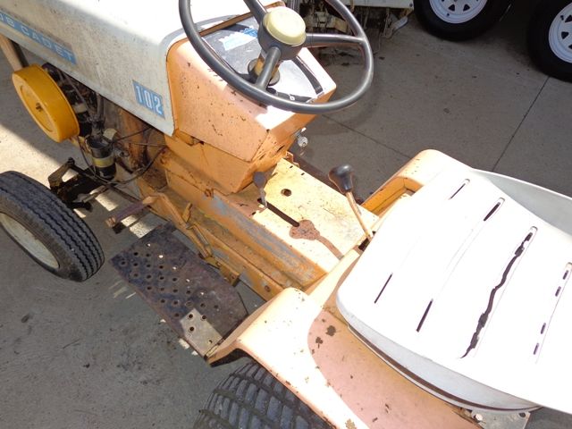

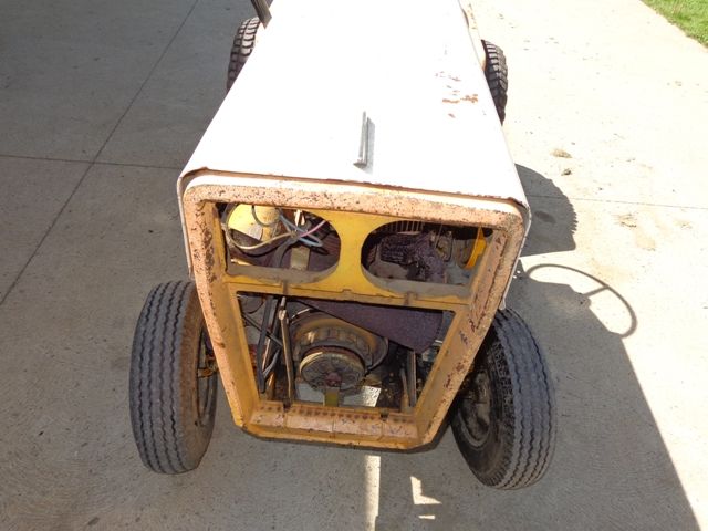

Some shots of the 102 so you dont think I was making it up We really do have one! I like it. Steers easy after a little steering tune up and some grease. Creeper works good.
I have the light kit and a grill. Not sure the grill is correct?
The Ohio Rubber seat has a crack all the way across but still functions!
It was so good, it got a chance to stay in side for a day or so.
