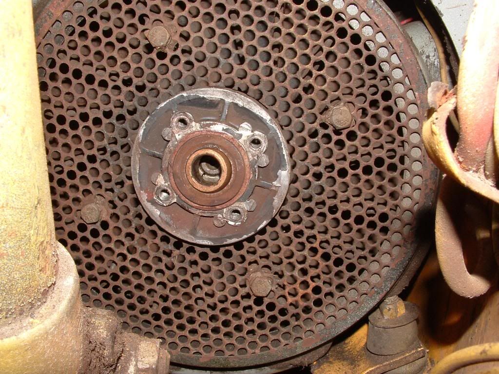

Howdy folks, I have a question about the engine cradle mounts. Should I assume that the mounts, both upper and lower should be the same height (except for the weight of the motor compressing the lower a little). In this pic of my flywheel in the lower right you can see the lower mount is alot shorter than the upper one, and I assume it is wore out. The other three are in similar shape. Can someone post a pic of some freshly installed mounts so I can see what it should look like? Thanks TB

I don't have a pic handy but the bottom mounts are pretty worn out, though I've seen (and had) worse. The happy middle ground to replacing the mounts, since they are $20 a corner for new ones, is re-use the upper mounts. Purchase 2 sets of new mounts, use the new on the bottom and leave the uppers original. Cuts your cost in half
