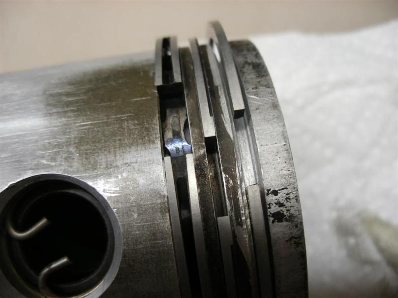

Man, someone abused this poor old K301 beyond excuse. This is from my 122 I bought from some kid who probably raced it down the street and who knows what.
The ring gaps weren't lined up like this, but the 2nd and the oil ring were lined up when I took it apart.
The 2nd ring is installed upside down.
The top ring has a bit excess clearance, would you agree?
Poor old engine... She's getting lots of new parts now. I'll never abuse her like this I swear.
She sounded like heck, and smoked like no tomorrow, but she still RAN! Kohler.

I've got a K241 that probably is similar inside...engine was said to have ran but smoked bad. I took the head off and found the piston is worn close to 3/16" smaller than the bore....I think it'll be fun to see what it looks like when I take it apart.

The amazing part (to me) was that the bore cleaned up at .010 over!
The piston had about 1/8" of "rock" to it.
