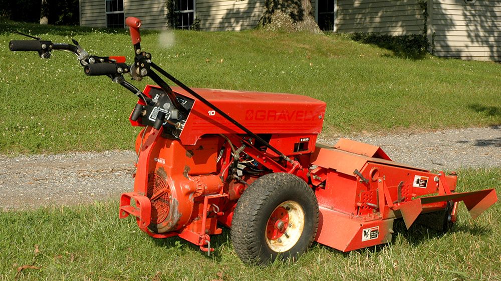

I'm wondering if there are different sized pulleys available for the "original"? I need to slow down more, but trying to avoid the expense of the creeper upgrade. I'm thinking a smaller engine pulley and the biggest one that can fit at the driveshaft. How do they attach and is this a reasonable thought?

The pulley on the driveshaft cannot be changed,it is part of the clutch,the one on the motor can.

I feel that it goes too fast. Ex. When you're mowing it needs more time to cut and more torque to go. Currently it strains to cut and go up a .75% grade in my yard. I would love to have the creeper gear but I don't and was informed that it is expensive.
Ok drive side no. Engine side maybe? What does the end of the crank look like? Tapered? Keyway? Has this been done?

Ok ok.yes it's an original. 7hp. Factory timed deck. The stopper holds deck up 2 or poss 3 notches from full droop (lowered). Yes the first time I cut it was past due considering I only had a push mower before. The belts were loose and looks like the small V belt on the deck is maybe a 1/2 inch too small as The blades spin without engaging the foot pedal, not full speed, more parasitic drag, but making it harder to turn and putting more pressure on the bearings.
I am just used to "tractor" gears. I was quoted 450 for the creeper setup. I imagine I could buy a rotting O with the creeper in it cheaper.
I'm a avid four wheeler and run Suzuki Samurai's. I change the transfer case gears from 2.26:1 to 4.16:1 in low and it allows the 50hp engine to power the little 4x4 over impressive obstacles.
I just need to get the creeper and be happy. Thought a pulley change would be a common thing. Oh well.
